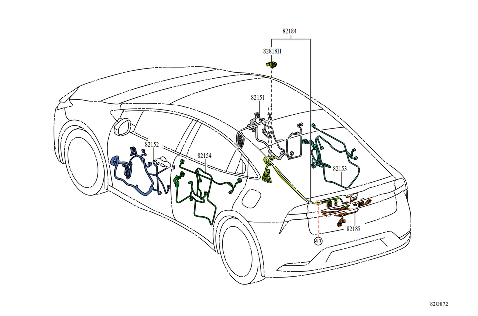

    I broke the clips on a part in the trunk and I'm wondering if anyone can help me find a replacement. I've looked online but can't seem to find the one I'm looking for.
    The part is on the right side of the trunk that connects the bottom to the hatch. It is a rubber boot that protects cables/water. The only cable it normally seems to house is the one for the rear glass heated element.
    Image if it ever works:
    or direct link:
    s-l1600 hosted at ImgBB — ImgBB
    I found one part being sold on ebay but it seems to be housing the radio wiring and it is listed as part # 86101-47U90-B. I believe that might be the left side but that's not clear from the diagrams.
    I have a Prime. I thought all of the boots would be the same but I'm not sure if the left and right ones are interchangeable but can't seem to find the part number for just the rubber boot.
    Any help?
    For the curious, I broke the clips wiring a rear dashcam.

    I think it's 82817-47Z50 - Wiring Harness Protector. It's the same part on both sides. MSRP of only $5.23, so I'd probably just order from your local dealership.
    It's the part labeled 82818H on the part diagram on this page:
    If that's not the correct part, then the only way you can buy it is by buying the entire wiring harness. It sucks, but that's the way Toyota is on their harnesses. Part number 82184-47800. $141.14 MSRP, about $80 if you wait for the likely 4th of July sale, around $35+SH if ordered from Japan.
