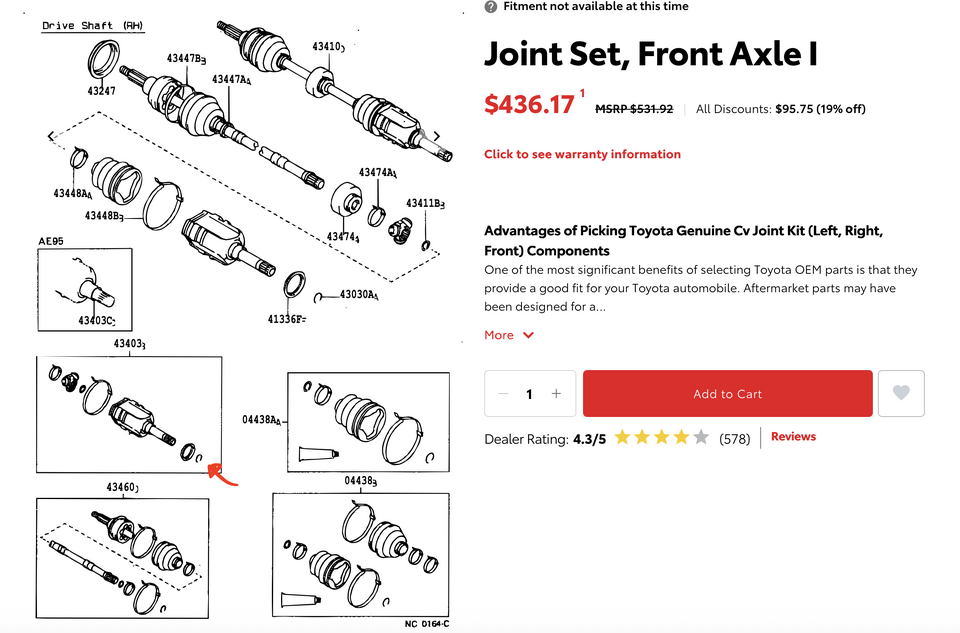

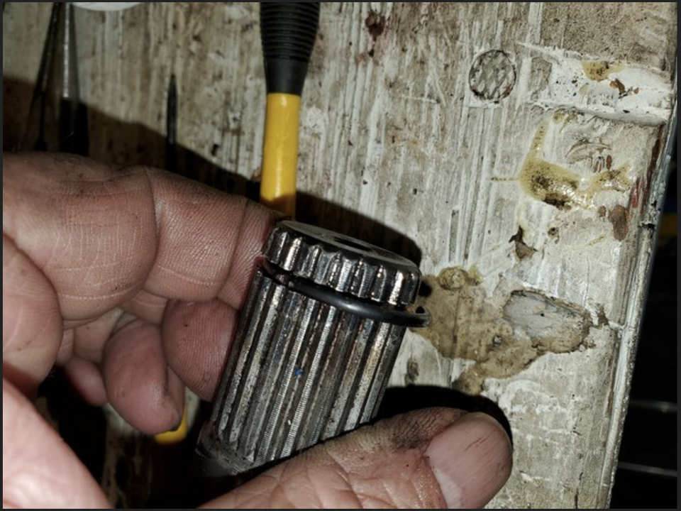

    So I recently got my passenger side axle rebuilt by a local shop and when picking it up, they said it did not have the snap ring axles have at the end of the spline where it connects to the transmission. They installed one that appears to fit loosely and when trying to install it, the axle will NOT go into the transmission fully. It tends to get caught on the snap ring and unable to insert it all the way in. I tried to lightly tap it with a hammer and nothing.

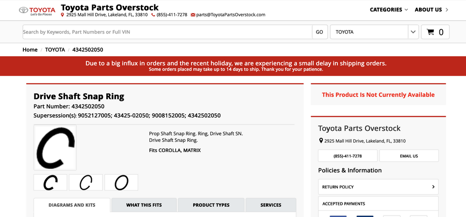

    I called them and they said that they use universal snap rings and that they installed the one sized to that specific axle. I tried everything, removing it and clamping it to close the gap more and even called the dealer to buy a new one BUT they advised this part has been discontinued although it is used on Toyotas from 1981 to 2024. I was able to find one for $2.10 at Bell Toyota in Phoenix, AZ but they are not willing to ship it to me,
    I went to various autoparts and they do NOT carry those rings. They showed me another axle from their stock and that ring is even looser fitting than mine so I am wondering whats going on.
    Below is the Toyota parts diagram and the red arrow is pointing at the snap ring in question. The snap ring part # is 43425-02050.
    Any help with this would be greatly appreciated.

    Solved either way, Turned out to be the spline on the shaft that was going into the transmission had damage to one of the lines or whatever you call it, so it would not allow 2 of the splines to go in smooth and was hitting there. I ended up replacing the head with the one of my old axle and installed the same snap ring and all is good now.

    The snap ring does not have to be there. I have several without it . You need to put the snap open at 6 o'clock for it to go in i promise so on insertion you don't wanna twist shaft more than one tooth to maintain 6 oo been catches at 6 it'll close naturally and drop in . 3 and 9 not too much . No lockring is Otay .. car won't even know and axles come out imed with bolts undone period.
