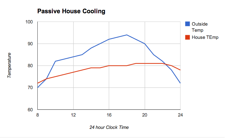

    I stopped using the ductwork for ventilation when I realized the blower uses 1 kW. My entire house uses about 3 kWh a day.
    I have some early AM light coming into the house coming into our NE and SE windows, but most of the windows are pretty well blocked. My main SE windows have external 95% shading from blinds. My guess, and it is a guess, is that most of AM temperature increase in the houses' air is from equilibration with the thermal mass of the house.

    If your graph is accurate, it looks like your house is heating up between 8 and 8:45-9 even though the inside temp is higher than outside.
    Do you have graphing of the temps before 8am?
    I would repeat the suggestion from others that you are getting unwanted passive solar heating. If you can lessen that impact it should help quite a bit.
    What interior thermal mass do you have? If it never gets down to ambient temperature, there may be a way to correct for that?
