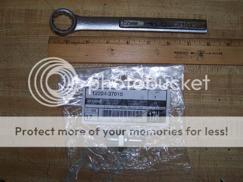

    BTW: I found a seller on eBay that will sell you a single 22mm Ratcheting Box End for $12.19 with free shipping. That seller sells any size from 6 mm to 32 mm a la carte. I have seen similar deals on Amazon, but not with Prime shipping. Cheaper than buying a Craftsman 22mm combo wrench, and then having the hassle of cutting it. Sure the $12.19 wrench is not craftsman quality, but tight can a PCV valve be? If it were a 22 mm body bolt, you would want a better quality wrench.
    Alternatively, you might be able to fit a deep socket over the whole PCV valve.

    A deep socket works fine, and allows you to torque it.
