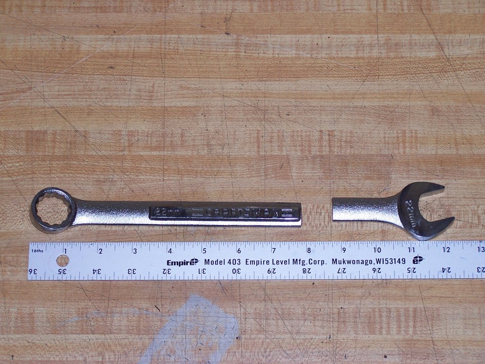

    The G3 PCV valve is located under the air cleaner assembly. It is a devil to get a wrench on. I removed, cleaned and reinstalled the OEM PCV valve at around 30,000 miles.
    The manual is not much help in either identifying or removing the valve. It calls for and illustrates a "ball joint lock nut wrench" which I don't have and looks too weak to break it loose. I used the box end of a Craftsman 22 mm combination wrench that I cut to length per the below picture to allow it to swing inside of the obstructed area of the valve. The only way I could get to it was from underneath the car.
    Good luck keeping your cool on this one. You will not be happy with Toyota about how extraordinarily difficult it is to remove and replace the G3 PCV valve. Let us know how you make out.

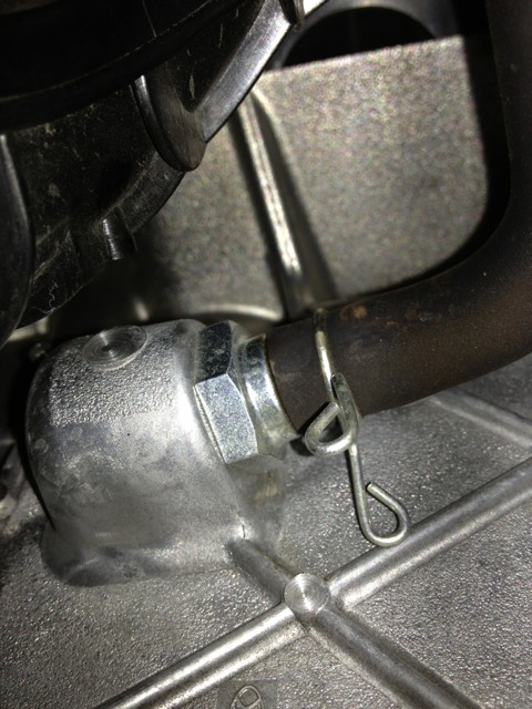

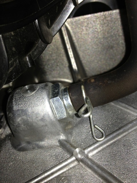

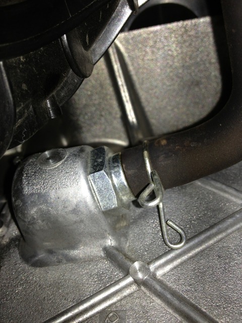

    I'd disagree with your disagreement, about best way to access PCV valve. I accessed it from below, just exploratory, since I don't currently have a long 22 mm socket. Plus I've only got 68K km's. I did pull the hose off, and it looked very clean.
    @NutzAboutBolts now has a good (access from below) video, pinned at the top of the 3rd gen maintenance sub-forum.
    From the bottom I needed to remove the shield, period. In addition to raising the front, that's 5~10 minutes labour. If you regularly raise and support the front, say for oil changes, that has GOT to be easier.
    Maybe @NutzAboutBolts 's 2012 is a bit different, he needed to disconnect a high voltage cable clip, to shift it a bit. In my case there was one coolant hose kind of in the way: I just pulled it back and secured with a bit of twine.
    A picture, looking up, front of car (and intake manifold) is at the top of pic. I've pulled the hose off the valve.
