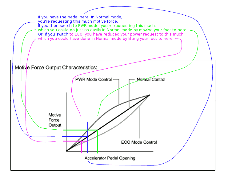

    Well said! Indeed, Brian's made several posts in this thread demonstrating complete understanding of the concept.
    I especially like the one I missed while traveling, where he reposted the graphs from the website of one of the vendors:
    The vendor's own graphs make clear that the device is taking an input signal (how far is the pedal pressed, 0% to 100%), and producing an output signal, also 0% to 100%, which is how far it tells the ECU the pedal has been pressed. That is, of course, all it can do, because it sits between the pedal and the ECU, takes the only signal the pedal ever produces, and supplies the only signal the ECU ever expects from it.
    That vendor offers not just several different levels, but three different families of "response curves", which can best be seen as a step-by-step journey through recognizing and addressing the drawbacks that are most glaring in the first approach.
    In this family—assuming the vendor's art department drew the graphs accurately—the first 10% of pedal travel is reported unchanged. Then there's a sharp change in the response slope, until (in the most drastic "race" curve) the ECU is told the pedal is fully depressed when it's only 25% depressed, and then the whole remaining 75% of pedal travel makes no difference to the ECU input!
    All of these mappings are complete, in that they turn every possible 0% to 100% input into some 0% to 100% output, and continuous, without any sudden jumps. But they're first-order discontinuous: the slope takes a sharp jump first at 10%, and again where the output meets 100% and the slope becomes zero from then on.
    Their next family of choices tackles the biggest drawback a driver would notice with the above: the fact that all of the possible control input has been compressed into an early fraction of the pedal travel, and all the rest of the pedal travel (the last 75% in "race" mode!) is useless. That could easily be annoying to a driver.
    In this family, they've given you back more of the original pedal travel, by adding another slope discontinuity, somewhere around 20% pedal travel. So you have unchanged pedal response from 0% to 10%, a sudden higher slope from 10% to 20%, another jump back to the original slope at 20%, so the final jump where the slope goes to zero only comes later, like around 55% pedal for the "race" setting. Even so, that still leaves the last 45% of pedal travel being useless. But that's a lot better than 75% being useless in the first approach.
    The next family eliminates the problem of useless pedal travel at the top.
    These curves all remain continuous and increasing and only reach 100% output at 100% input. The racier ones move more of the pedal response to the early travel, but they all still have something left for the remaining pedal travel to do. So, this family fixes the drawback of wasted pedal travel seen in the earlier two families.
    Also, these maps are first-order continuous—the slope changes smoothly—except, still, for that first abrupt change of slope at 10%.
    Edit: well, looking again, "race" is 1st-order continuous all the way to the top (excepting that first jump at 10%), but the other choices still do have a second slope discontinuity where they rejoin the original line near the top. Assuming that really is their design, and not just something their art dept drew wrong for the website.
    Drivers who avoided math might not have the language to say "gee, that response curve has a first-order discontinuity around 10%", but probably still will notice it and think "man, something feels goofy around 10% pedal".
    If you iron out that last drawback, and make your family of curves fully first-order continuous from end to end, going from 0% at 0% to 100% at 100% and wasting no pedal travel in between, you end up with curves like Toyota gave you in gen 3:
    All different ways to play the same game of mapping a 0% to 100% pedal position signal into a different 0% to 100% pedal position signal, but illustrating that there can still be worse and better ways of doing it.
    Thanks to Brian for collecting the necessary graphs.

    Alright.....Bill since you think these kinds of devices do nothing but you can see that Toyota offers 3 curves and there are added curves when using one of these devices.
    What you are failing to understand is your foot can not mock these devices one bit.
    One would only know how well these things work if they were actually able to understand the product.
    You would need to care enough and monitor the rpms and actually know what the prius sounds like.
    Tell you what...go outside today and take a spin, get to speed and keep a set speed, then make sure you select Normal instead of power or eco.
    While you are driving and if you can keep a steady foot keeping that speed, switch it from Normal to Eco while still maintaing your foot position, if you were able to see the rpms, you would notice a 400-600 rpm drop and if you would switch to Power, you should really hear your little engine.
    You can probably do the same in cruise control and you can switch between the 3 modes that toyota gave us.
    Now I think you accept that the device offers different pedal curves, so there are more options to choose from with one.
    Think about this for one teeny tiny second...you say there is nothing your foot can not do from 0-100 that these device can do but then why did TOYOTA give us 3 options to play with if pedal curves do nothing?
    Guess those buttons are just dummy buttons and dont actually work.
    I know they work because I monitor things and I always stay in ECO mode and have plenty of power and I can cruise very smooth and quietly at speeds of 50-80mph and be at 1000 rpms.
    I think this thread shows us that you are not the type to want to use this, so if thats the case and you think you made your point a long long post ago, then why are you still here?
    Thats like someone saying oh I dont like to watch these kinds of movies/films but you are still watching and commenting on them.

    Yes, that's correct. All of these 'change the curve'.
    Yes, I can put my foot on the Go Pedal and input 0 - 100%.
    Yes, toyota gave us buttons "to play with".
    Yes, those buttons and this doodadd change the curves. They 'work' at changing the curve.
    Yes, I consider them all 'dummy buttons'.
    Who are they fooling?
    My Gen4 has a different normal curve than my Gen3's. But if I drive them at the same acceleration rate, who cares?
    Remember, the end result is your butt in the seat and how you feel the acceleration.

    Sure thing. What are you thinking that tells you that we didn't already know?
    Different people like the way the different curves feel, and would rather use the curve they like the feel of than push their foot to the equivalent point on a different curve.
    Nothing wrong with accommodating people's preferences. The conversation only gets thrown off when it's suggested the device does anything beyond remapping the simple pedal position input.*
    * well, Toyota's options do have another effect: the ECO mode puts some limits on HVAC. That's the main reason I use it (and I don't much notice the pedal remapping that goes with it, as I end up just pushing my foot however far it needs pushed anyway).

    Well I monitor my Prius and can see the rpms drop and rise when selecting the 3 modes Toyota offers.
    I use ECO mode all the time but if I could get a better more fine tuned eco curve, then I would try to get that and test it out.
    Like you said different people like different curves.
