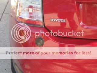

    I just picked mine up today. It's the 2kWh version. I'll be upgrading to the 4kWh version soon
