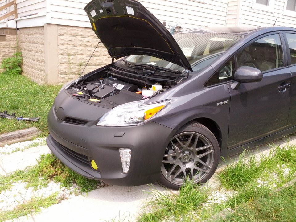

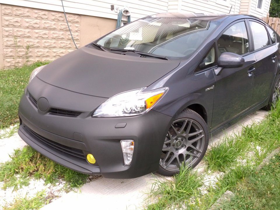

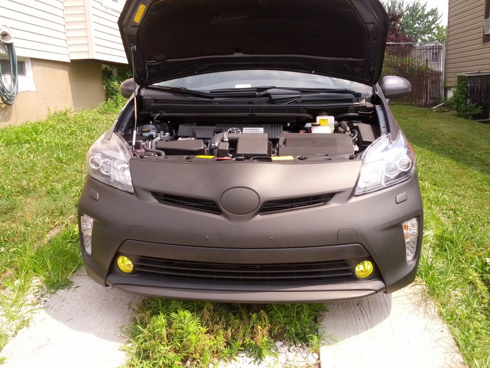

    Today is waaaay too hot to be outside working on the car. I really do wish that I had a garage. The mod list would be dwindling so much faster! I need to finish wrapping the rest of the car soon. It looks a bit odd right now.
    I really wanted to get the headlights wrapped in clear Lamin-X film, but after three failed attempts, I gave up. I'll give it another go down the road and use the pre-cut films. Trying to use custom cut for the headlights was too much of a pain. There are so many curves to that thing, it was almost impossible to get it looking clean.
    I'm also not sure if I like the forward emblem blacked out, or if I want to let it show.
    1) Wrapped the front bumper in black matte vinyl by 3M
    2) Painted over the plastic gril insert, and lower grill insert in flat black Plasti-Dip.
    3) Wrapped the DRL/Turn signal lamp in Lamin-X clear film
    4) Wrapped the foglight housings in Lamin-X yellow film
    5) Disabled the low speed noise device
    This was extremely difficult to do. To do it easier, and better, it should probably be wrapped while it is on the car. I took it off because there was no way I'd be spending 2+ hours out in the sun working on this.
    You also need two people to work at it, one person to help pull and stretch and the second person to work the details. Overall, I'm satisfied with the work done. There are a few small creases, and some tight areas that keep bubbling. I really want to do it over though, but the amount of time this took, and lack of an experienced and willing second person are holding me back from attempting it a second time.
    I wanted to paint over these two parts to match each other in color/texture. I was mainly motivated to do this work because the lower grill insert trim was a gloss metallic black. I thought that would look odd against the color of the matte black vinyl so I decided to paint that and the upper grill pieces.
    I did this to aid in protecting the lens from rock chips, etc. The upper section, the turn signal area, was a difficult install because of the way it's curved. It took some time using a heat gun and pushing out the water/air to get it to lay proper. I custom cut a sheet of clear Lamin-X for this job.
    I did this to aid in protecting the lens from rock chips, etc. I also like the look of yellow fog lights, so I decided to wrap these in yellow film. These were fairly easy to install. I custom cut a sheet of yellow Lamin-X for this job.

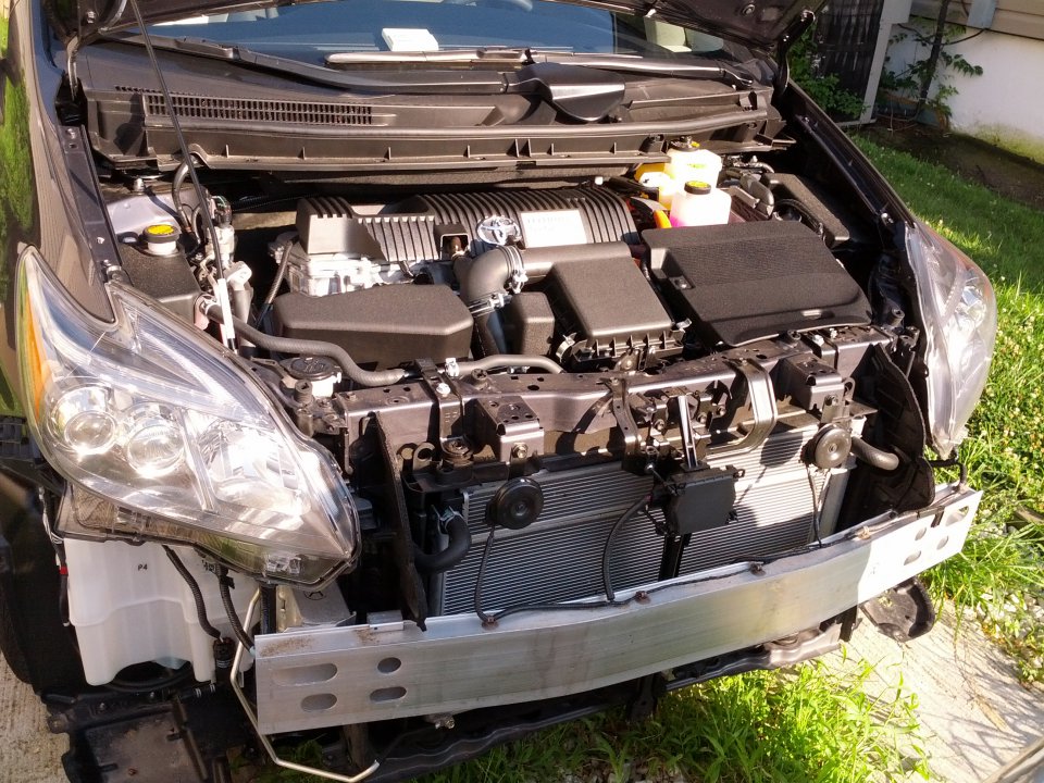

    This was easy to find with the front bumper removed. All you have to do is unplug the noisemaker from the harness and viola, no more sound.
    There is a blank plug right next to the noise maker, that I assume is used so that you can plug the harness into it so a short doesn't occur from water splashing into the area. I should have taken a picture.
    Unplug noisemaker from harness, plug harness into blank/unused clip.

    Good question. I shall see. It's just vinyl overlaid on top of it. I'll take her out for a spin shortly. I figured it would be safe since the actual radar unit is behind and completely separate from the emblem. Maybe the emblem acts as some sort of deflector dish or something? :)

    DRCC tested. A vinyl overlay does not impact or hinder performance. Tested at all three distance settings. Tested with cars merging into and departing from my lane. Throttle and brakes are engaged accordingly.
