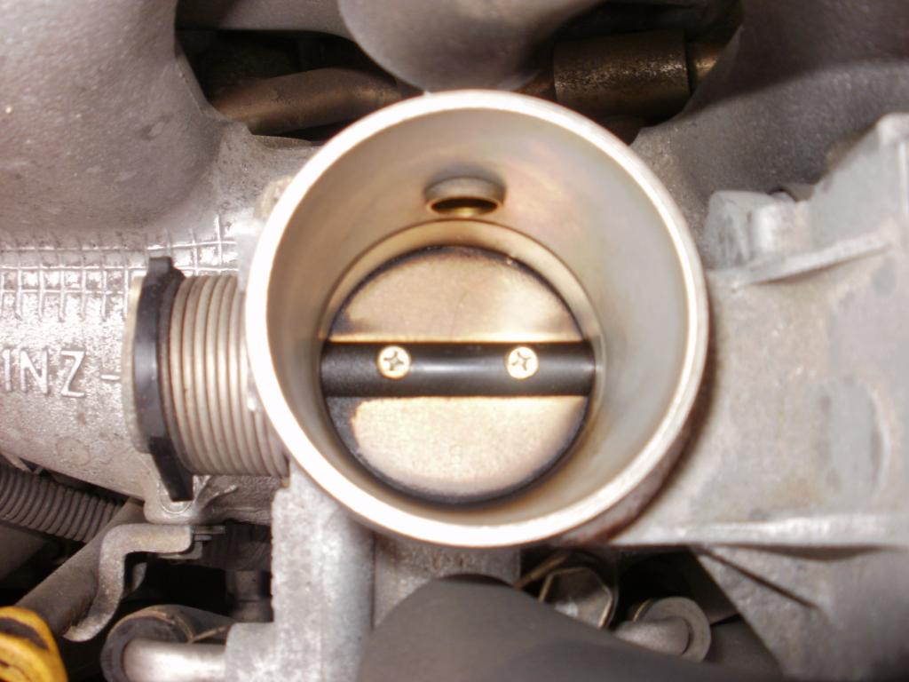

    Remove the plastic intake housing after disconnecting the MAF wiring/connector, then use an old toothbrush with a little bit of rubbing alcohol or vodka, the bore/plate will clean up in seconds.
    If the intake looks like this or worse, then it is considered dirty.

    Like I said, to me that looks squeaky clean! Mine was black all the way down and I scrubbed it up to this level. I'm amazed that this small amount of crud can cause a problem, but I'm happy to go back and do it properly, especially if I can regain some points from the domestic authorities by getting her car working again!

    Here we are again! Throttle body is now so clean you really could eat your dinner off it... The process sent a whole can of carb cleaner into the manifold too... Guess what...? It started and ran for much longer than before and I was almost ready to smile when it died again. After mulling this over yet another cup of tea with my son who seems to grasp how these things work far better than me (not difficult), I have reasoned thus: Car starts when the system is in "start mode" and is richening it up for 5 seconds or so while the sensors do their checks. After that, "normal tickover" is resumed, the mixture is weakened and it dies. With a ton of highly volatile carb cleaner going down its throat, it managed to run for longer, so I'm looking at either a fuel starvation issue, bad fuel, or diesel in the bloody tank. I am now going to take the rear seat squab out, remove the pump and see is the filter is blocked, or the fuel is contaminated. Oh joy of joys...
