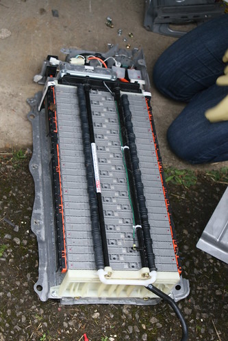

    Here we go - Some photos!
    As the Flying Dutchman pointed out quite fairly perhaps we paid a little too much for the pack. However, they seem as rare as hen's teeth over here so I'm quite happy I have one. I was offered one from a mark II prius at a much higher price which of course I turned down. :)
    On Saturday at our local EV/Hybrid barbecue (it was held at my home) a friend snapped some photos of the pack and the the other goodies from my trip.
    With the top off the pack it all looks pretty healthy. Everything I need is in place, which is better than some packs I've seen (or been offered). It's a shame the top is a little bent. We're also missing the cover nearest the camera at the end, but since I'm going to be repackaging the cells anyway that's not really a concern for me.

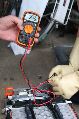

    With correct lineman's gloves (or should that be linewoman's ;) ) the pack reads 215 V off load. Please don't do this to your pack unless you've got the appropriate gloves eh? The white ones are rated to 1000V

    when you disconnect the big orange fuse there is now voltage on the part your measuring i tested that last weekend
    hope you find that 2e pack for a not rip off price:D;)
    edit : i see at the picture's comment you already figured that out

    When you're dealing with voltages high enough to instantly kill you there's no second chances ;)
