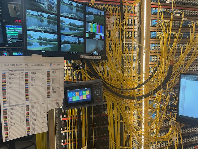

  14. ColoradoCrow
    ColoradoCrow Senior Member
    Sep 2, 2019
    1,108
    464
    Leawood, KS
    I
    Running an OTDR myself for Fiber Optic Temp system on the PGA Tour. Yes your line has been cut and they will need to find and repair it. We had 2 lines cut near KC Metro within minutes of each other. 2 vandals working together to take down a grid. It was repaired in short time. FBI is investigating and domestic terrorism charges were being sought. Time will tell.
