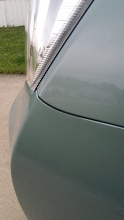

    Hi.
    Please help me. This thing drives me nuts.
    I own 2014 Prius Four Sea Glass Pearl. I purchased mine in January. I have been through kinda busy days, so I could not get any chance to inspect my car carefully.
    Unfortunately, I recently notice that there is a very slight gap (but noticeable) between the passenger side rear bumper and the quarter panel.
    Plus, there is also another gap between passenger side tail light and the quarter panel.
    UNLIKE DRIVER SIDE! Everything looks perfectly assembled on the DRIVER SIDE.
    Mine has never been even in any minor accident. I have never sit on my bumper either.
    After I noticed it , it drives me crazy. I already took mine to a dealership, and the technician told me that it is a very ordinary flaw that Toyota is aware of.
    Is it TRUE??? IS IT REALLY NORMAL ISSUE???

    I have a news. I brought mine to a Toyota technician who is my best friend. And he answered like below...
    1) a gap between the tail lights/head lamps and the body panel => Toyota FR-S had a issue with waterlogging in the lights because of poor sealers. So Toyota changed all tail lights & head lamps with much more sealer for their all models. After that this issue started being reported. But there is no solution for this.
    2) a gap between the rear bumper and the body panel => Toyota HQ is already aware of this. It is caused by it's unconventional material. Especially during summer, it could be worse, if you park in the sun light.
    HOWEVER, it depends on luck on your side... it means mine was out of luck.

    that picture is shocking!:eek: mine doesn't look anything like that. i think they are giving you the runaround. have you checked other cars on the lot?

    Yes I have. Because he recommended me to do it. I found 6 out of 10 have this issue. In the lot in the sun light.

    Saggy butt syndrome. :) Likely that the mounting fasteners are loose or missing. Should be covered by the warranty.

    i don't understand why it can't be repaired, it's almost like they don't want the bother. but toyota should be paying for it, the dealers usually love that kine of work.

    Do not take it to a body shop. This is normal. It's a quality issue that Toyota is not going to fix. As Spindifferent stated, it is the "saggy butt syndrome." Nothing you can do. Some rear ends are saggier than others Lmao.
