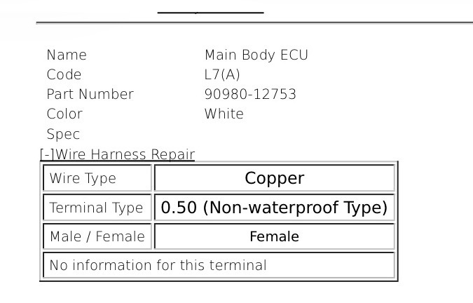

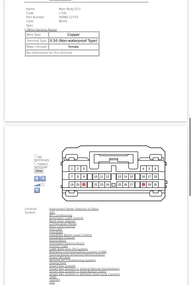

    I’m trying to find the pins to add to the L7 BCM connector. I have tried AI to find them, that was a nightmare. I have purchased every size pin, except the ones that fit. I’m trying to hookup the light sensor on the dash, I have ran the wires just need to pin it to the BCM. I have already bought the stalk with the auto function, pinned its connector, but it also connects to L7. So if anyone know the connectors female pin, please let me know.
  2. ChapmanF
    28,725
    19,025
    Yeah, those are the little 0.5 mm non-waterproof ones with "no information for this terminal" because they're not in Toyota's distribution. The real ones look like this:

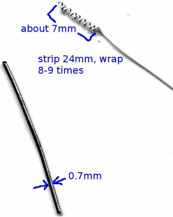

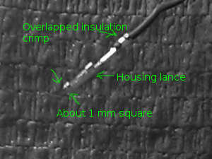

    and the ones I made look like this:
    where the 0.7 mm thing is a random end I clipped off some electronic component some time, and I used it as a form to wrap some wire-wrap wire around eight or nine times. You can read about it ➡here⬅.
