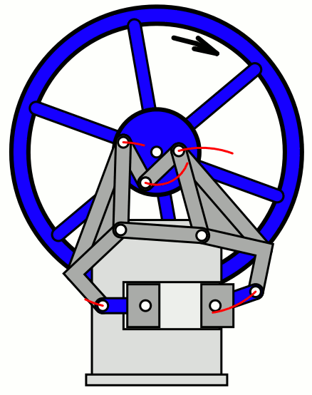

    What I mean that on real Atkinson compression and expansion ratios did differ due to additional linkage. On modern modified Otto cycle engines (also incorrectly called Atkinson) the difference is simulated by using late valve closing. But this (or any other magic with valvetrain) does not really change compression ratio as "the ratio btw minimal and maximum volume on compression stroke"; if it did then the high revving motorcycle engines shouldn't really be rated at 12.5:1.
    Here is more on Atkinson:
    Atkinson cycle - Wikipedia, the free encyclopedia
    With opposed pistons:

    They can say whatever they want but it is not Atkinson engine. His patent specifically calls out linkage design, as the way to eschew Otto patents.

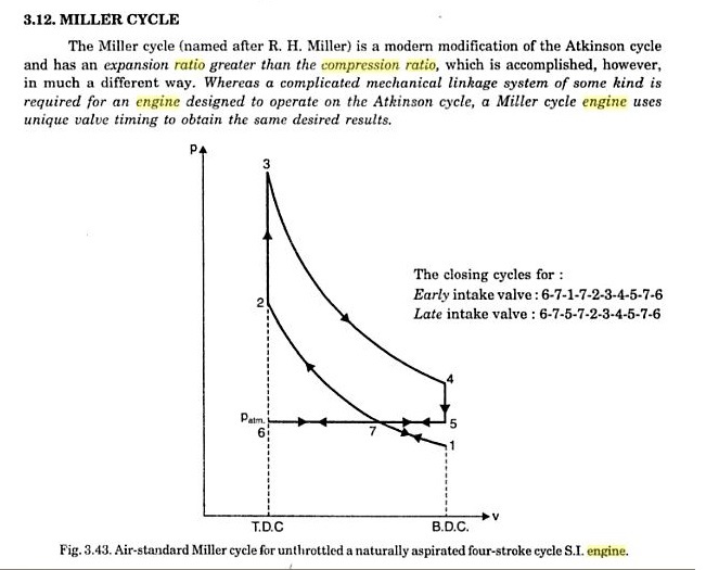

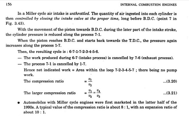

    Here is a text that gives both definitions of compression ratio. Mine matches equation 3.20 (cr = v7 / v2), while Cylcopathic's matches 3.21 (cr = v1 / v2).
    From A Textbook of Internal Combustion Engines, R. K. Rajput, Laxmi Publications Pvt. Ltd, 2007.
    #76 fuzzy1, Sep 4, 2015
