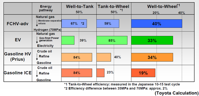

    Well, this one said 84%.

    Is there a report attached to that graph?

    This paper was just interesting because it pegs a refineries electric use for gasoline production at just over half.
    https://www.google.com/url?sa=t&rct=j&q=&esrc=s&source=web&cd=3&cad=rja&uact=8&ved=0CDQQFjAC&url=https%3A%2F%2Fgreet.es.anl.gov%2Ffiles%2F1c49xpjg&ei=001hU__aHOqpsQSK14CoBQ&usg=AFQjCNFNj86V3TM0Vokj1k74YGvzsebbnw
