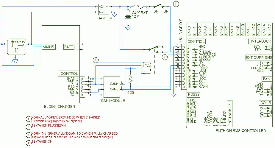

    Below is a picture of an Elcon PFC using a serial-CanBus interface device.
    [IMGLINK[​IMG]][/IMGLINK]
    Note that, for this to work:
    • The ElCon charger must come with the optional CAN bus module
    • The Lithiumate controller must have software revision 1.07 and up
    • The CAN module does not include a CAN termination: an external termination resistor is required
    • The CAN module occupies the 7-pin control connector, yet that connector is required to detect AC presence; therefore, you need to open the 7-pin connector and bring out wires
    • CAN module built before July 2011 cannot handle being on buses that contain more than 2 messages per second!
      • Too many messages on the CAN bus slow down the ElCon charger, reducing the rate of its output messages, and may crash the charger, which will seize the CAN bus
    • The ElCon charger CAN rate is 250 kHz by default and not user programmable (though it can be special ordered at other speeds)

  11. Flying White Dutchman
    Dec 29, 2007
    4,374
    313
    there are 2 versions
    A: version with canbus interface where you set the voltage and amps
    B: version without canbus but whit a analog voltage wire where you can control amps output based on 2 ( 0 amps ) and 5 volts ( 100% amps so 5 amps in this case )
    in the manual is the info about that!
    the chargers putsout 12 volt on pin? X and there is a input wire where you can direct that 12 volt to when its direct connected the charger wil work at full 100% amps but when it drops down below 5 volts it wil also drop its current.
    when its below 2 volts it will stop charging.
    between 2 and 5 volts is where you set 0-100% current.
    8-2
    Control mode : ENABLE CONTROL
    1. Charging process: Constant current (this current is controllable) charging mode is applied first, then constant voltage charging when the battery reaches the specified voltage point. The voltage does not increase in the constant voltage stage and the charge current will gradually reduce. Charging ceases automatically when the current falls to a preset value (generally one tenth of maximum charging current). If ENABLE signal is removed at any time, charging ceases.
    2. The ENABLE/+12V wires can be used to control the charger by an ON/OFF signal from a battery management system.
    3. Alternatively the voltage between ENABLE and GND can be used to linearly control the charger output current.
    When it is above 2V, charger commences charging. Applying 2~5V can control the maximum output current.
    Below 1.5V the charger will cease charging, re-applying above 2V will re-enable charging.
    http://faktor.de/images/pdf//LAD/POWPFC1bis8kWSpec.pdf
