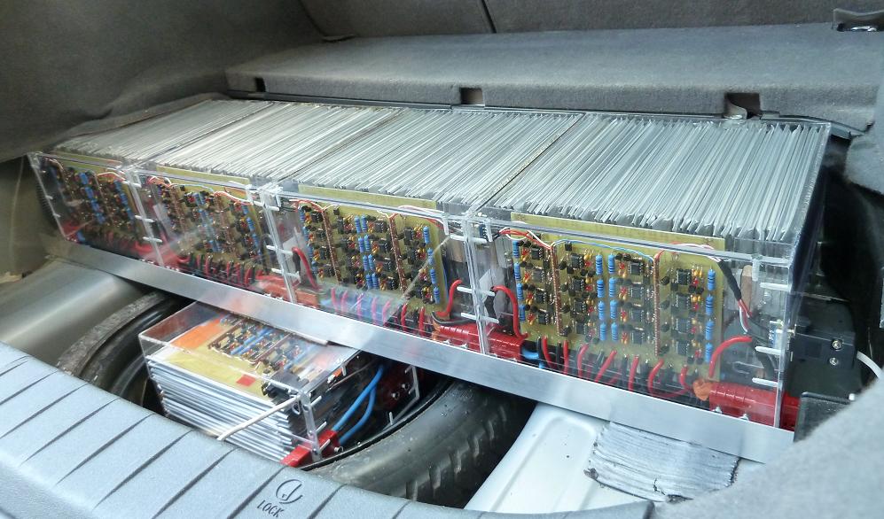

  13. planetaire
    planetaire Plug in 20 kWh 85 km/h or > 208km range
    Aug 11, 2009
    190
    139
    France
    all. Yesterday was a very nice day.
    Just begining testing my V2.0a+ plug-in prius. This version has twice the capacity of the previous : 9kWh.
    For a total of 140 A123 cells connected 2 by 2. Yes this is not a dream, there is really 140 20Ah cells.
    First road test was 43 km. Voltage at begining was 235v, at the end 228v. Speed goes up to 85 km/h during few moments. Used 95 Wh/km.
    With the previous version (4,5 kWh) the voltage would have been near 213V after 40km and cells really depleted.
    dave77 and jdh2550 like this.

  16. ericbecky
    ericbecky Hybrid Battery Hero
    Mar 12, 2004
    4,452
    3,359
    Madison, Wisconsin
    I am very interested in the connections between the cells, how you put the packs together, as well as the balancing boards.
    Where can I read more and see more pictures?

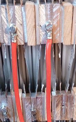

  18. planetaire
    Aug 11, 2009
    190
    139
    France
    In my album called "can"
    These connections are made for cells without tabs. If I have to do it one more time, I would really prefer cells with tabs.
    Here the connections for the 9kWh:
    The bms is the same : peter prkins.
  19. lopezjm2001
    lopezjm2001 Senior Member
    Apr 14, 2009
    1,146
    407
    Sydney Australia
    I did mine without tabs. It felt like I was one of those Chinese factory workers. It was a real PITA. Never again.
  20. Flying White Dutchman
    Dec 29, 2007
    4,376
    313
    i did with tabs!! pfffff lucky me i did get them with tabs!!
    so guys only buy with tabs!! maybe a little more to pay but well spend money
