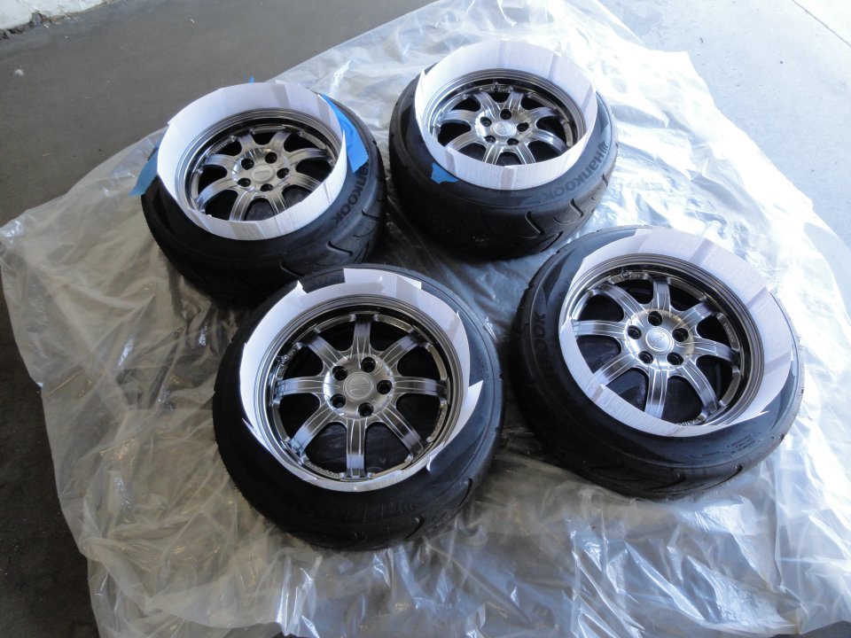

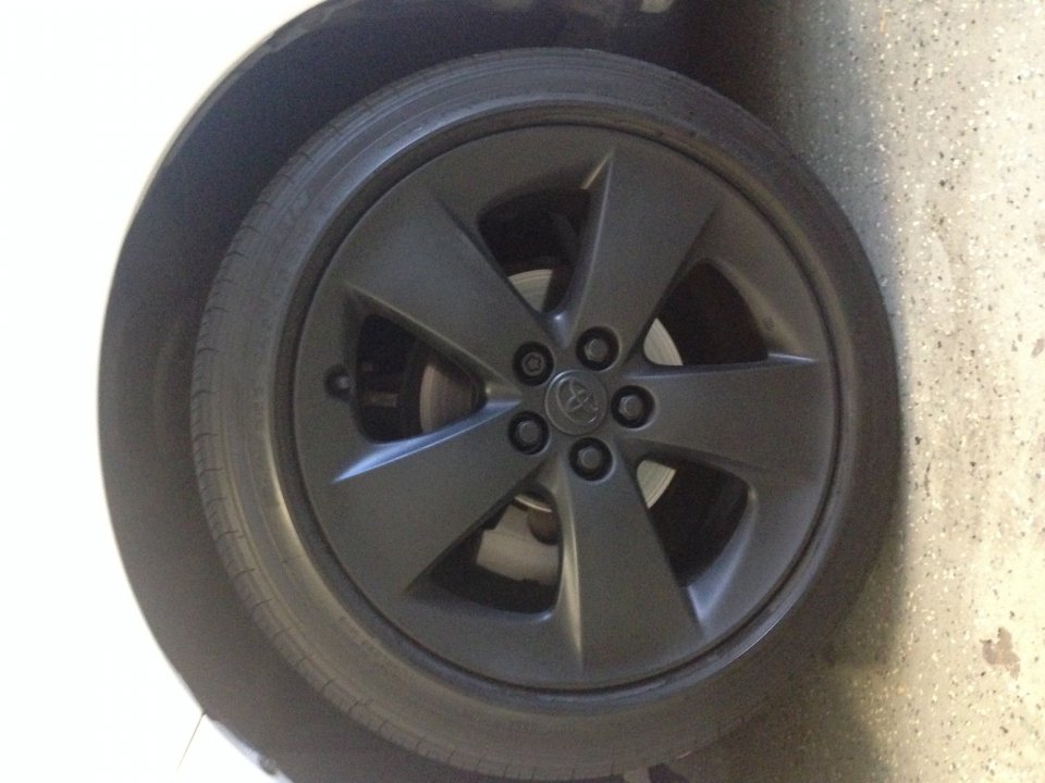

    Hey everyone - I just wanted to share my experience of Plasti-dipping my rims white.
    Plasti-dip is a spray on rubber-like coating. It is totally removable. I decided to black-out my emblems and turn my rims white. You can get it at Walmart, Home Depot, or Lowes.
    I originally did one can, which gave me 4-5 coats per rim. However, a few months later I bought another can and did another 4-5 coats per rim.
    It's quite simple, but the prep takes the majority of the time. It's important to get plastic bags behind the rims to protect the brakes and calipers. Also, cover up your bolts for your rims. Last, make sure to prevent against overspray on your tire. It's important to put something, I used masking tape, between the rim and the wheel so there is no way it can get onto the tire right outside of the rim.
    I have attached a few before, after, and during pictures.
    Enjoy!
