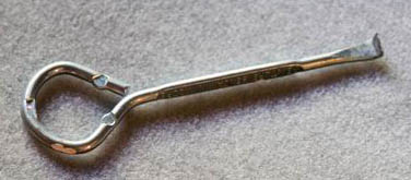

    Here's a tool I've adapted for use with the regular, center pull type:
    It's actually a paint can opener, but well suited for lifting center post fasteners. A thin blade screw driver is more suited in some cases.
    Also, any time you have the fasteners off the car, try to wash/hose them off, get the grit out. Helps them last.

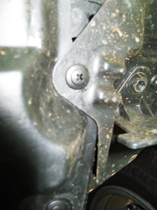

    A better plastic rivet is the one with a Phillips screw insert. They are held by many small "interrupted screw" ratcheting threads. They were an earlier version of the current clip but required more force to install. I replaced many of the current push rivet clips with these. I had these on my 1987 Mitsubishi and my 1998 Mazda. They never worked loose except in a collision. I've posted a photo. You remove them just like you'd remove a Phillips screw.
