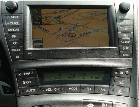

    If the image below is the premium HDD, then I can assure you they do read DVD data discs with mp3's. I tried with a DVD+R disc. Only catch is that there is a limit of 8 nested subdirectories and a maximum of 255 files. 255 files from my music collection (bitrate 128-160) is about 1,5 GB, so you're losing out on a lot of usable space.
    The plus side is that it reads mp3 tag info properly and does not use the botched "6-disc changer" approach like when you attach a USB stick or an ipod.
