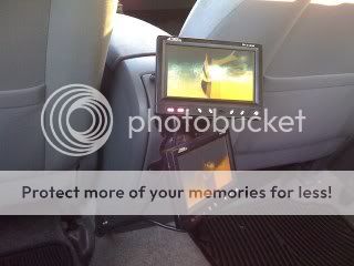

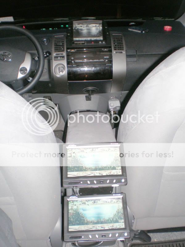

    Here's what I did and how I did it. Enjoy... happy modding
    The guide is attached

    The most recent one is for the rear LCD's... the other one is for the front (MFD) only. The only part that the explanation is missing is :
    Run the wires from the PS2 into the input selector switch. run the output from the output to the lockpick MFD.
    in the recent guide, i realize not that I input into the MFD is assumed to be through the lockpick.
    I didn't include any guide to the installation of the lock pick because the one from coastal tech is so good. (and there's a good video on here too)
    did that clear anything up or add to the confusion?

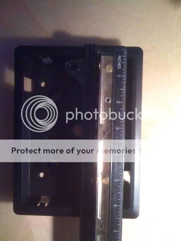

    I originally wanted to put them in the headrests, but have you ever looked at the back of the pri headrests??? They're really little. The monitors i have are a 5.9 inch vertical (on the definite smaller side) and even these little guys wouldn't fit in! THe measuerments are 5.75x4.25, they come with an flush mounting which increases the outside length to 6.5 inches.
    This just puts the corners over the edge of the headrest and I didn't want that... so I stuck them on the console.
