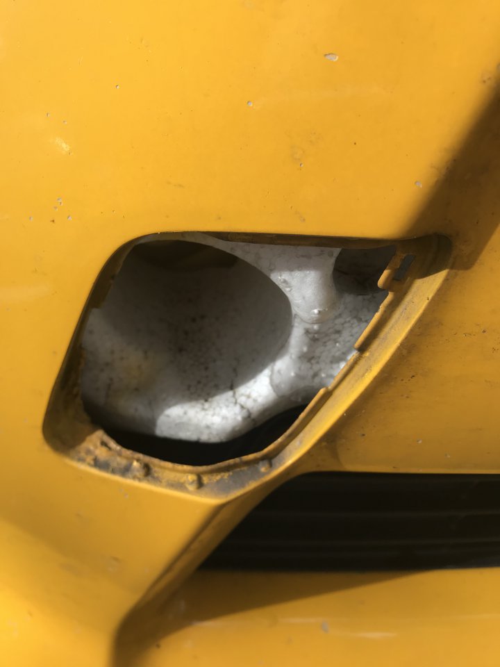

    Does someone know what part this is? or how to go about ordering it?
    I am afraid to go to the Toyota Dealership because they try to rip me off and I lost my job due to COVID so I can't pay for something if its super expensive to fix.

    Here's the Toyota part. $17. Not sure if it comes in colors or if you have to have it painted.

    These "tow hook caps" very commonly fall off. The cover has a latch system that is very similar to how the battery cover on a TV remote control clicks into place. If you can replace a battery in a TV remote control, you can install this part.

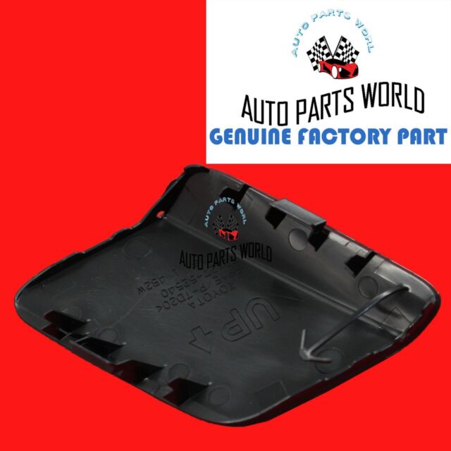

    If you search ebay for "Prius C tow hook cover", many options will appear. This one is $15 with free shipping. If you're not able to get one with your color, every autoparts store like AutoZone, has cans of touch up paint available. They should be able to get the color matched pretty close.
    GENUINE OEM TOYOTA 12-14 PRIUS C FRONT BUMPER TOW HOOK EYE CAP COVER 52127-52941 | eBay

    Little detail: the new part will have a skinny little tether on the back sticking out from one corner. You can see it here, like the little pokey plastic tethers that hold tags on new clothes:
    Just poke that through the small hole you see in the top right corner of the opening here:
    That way, even when you pop the cover out, it doesn't get lost.
