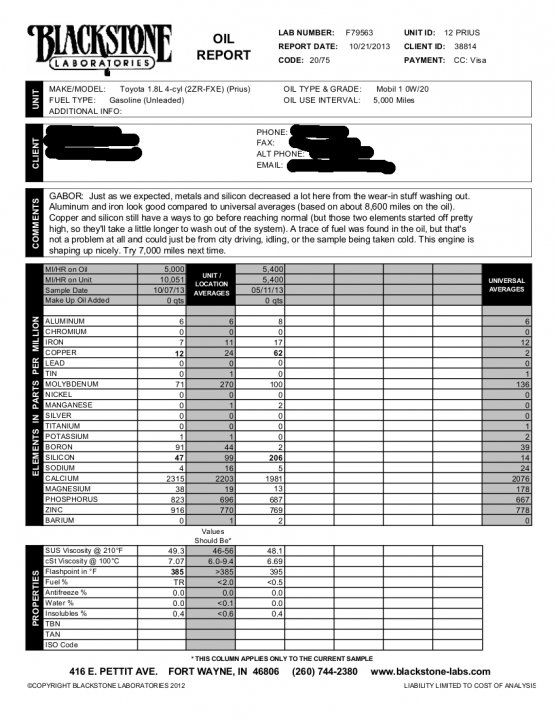

    It tested as 30 oil, but UOA mistakes are very common. I stopped doing UOA after getting nonsense results from one lab. No quality control in this industry whatsoever.
