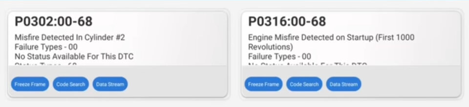

    You have to pressurize the coolant system when cold and use an articulating borescope.
    Gen3 Prii are not the only engines with slow cold start leaks.
    The Ford Edge Ecoboost engines are very similar but with a diagnostic advantage. Their misfire detection accurately determines cylinder and they provide a PO316 "Engine Misfire Detected on Startup (First 1000 Revolutions)" that the Prius does not generate.
    Ford also does not recommend hg change alone. Instead they sell a discounted engine. Toyota recommends rebuilt but does not discount engines or short blocks.
    Toyota did acknowledge their low tension ring problem and replaced thousands with excessive oil burning and resulting carbon buildup free in the first 5 years or 60,000 miles.
