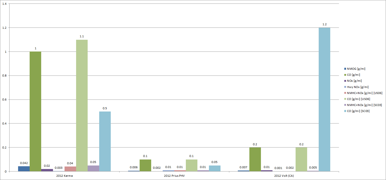

    On the topic of emission, the chart was made from the data in CARB emission certificate. The Volt (CA) shown is the special cleaner version available in California that qualifies for the HOV lane. It is not available in all states.

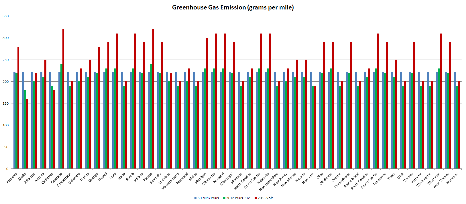

    EPA also rate the plugin vehicle emission by combining the tailpipe and upstream (fuel production) emission together. Using average emission in the entire United States, this is how it came out after I sampled one zip code from each state. For more info, see this thread which includes the source of data, etc.
