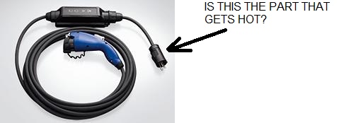

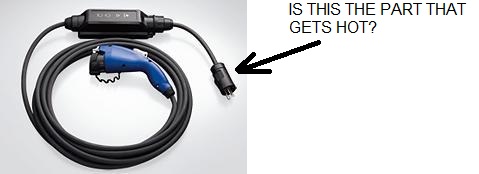

    I've had my 2012 plug in for just about a month. I set the timer to charge overnight from 1:30 to 4:30 a.m., which it is doing just fine. But when I go to unplug it at 7 a.m. the thick black part of the plug -- where you grab with your hand to pull the plug out -- is really warm, even hot. Is this normal? I installed a brand new outdoor outlet with a tight rain cover, so i can't imagine that is the problem. I'm concerned the hot plug might still be drawing some charge, and that it might be a safety hazard. Thanks, David in Long Beach, CA.

    Agree with Prius2007User.
    Understand you are referring to the handle that connects to the car. There should be no live electricity there after charge is complete! both the EVSE (the brick) and the charger inside the car should disconnect this area.
  8. bisco
    115,454
    52,858
    yes, a bit confusing. are you referring to the plug that you plug into the wall outlet? about 2" long and 1 1/2" in diameter? not counting the 3 prongs? if so, i don't think it get's very warm, and certainly not hours after charging.
  9. ny_rob
    ny_rob Senior Member
    Feb 28, 2012
    1,968
    814
    L.I.- NY
    Op- I read that you are referring to the 3-prong male plug that plugs into the 120vac on your house- correct?
    That part should not get hot when charging the Prius, it shouldn't even get warm.
