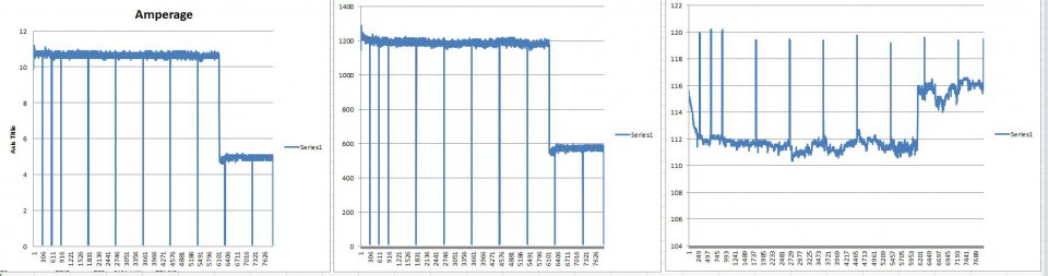

    maybe it's tripping it when the charging is at the last ten minutes of charging, because I have monitored the voltage and current using a data logger and using Excel displayed the current drop from 12 amps to 6

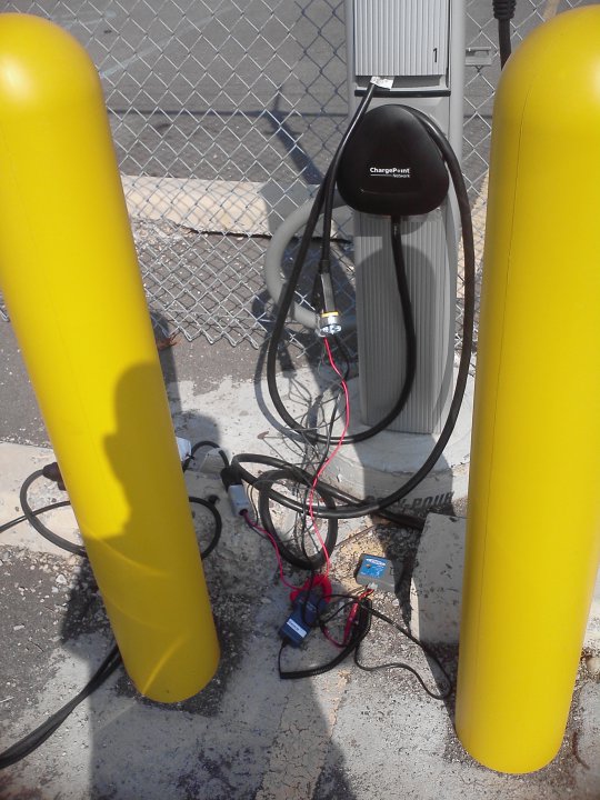

    that's a picture of my data logger hooked up at my local ChargePoint station

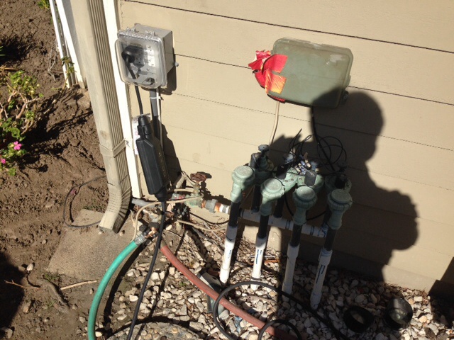

    Final Update: My electrician figured out the dedicated outside outlet I was using was NOT grounded. Yikes! Ran a quick ground to the nearby water pipe, and everything is working fine now. Here's the charging set up....Thx for all the replies.... image.jpg

    There is an easy way to test for ground - no electrician needed. Just get a $3 test light and touch it to both the Hot (smaller) slot and a metal part of the outlet, like the center cover screw or the case. If it lights, the outlet is grounded. (In the case of the box, it means the box, at least, is grounded. Check the outlet too.) If there is no light, try the neutral (larger) slot: if it lights then the outlet is wired with reversed polarity, and should be fixed.
