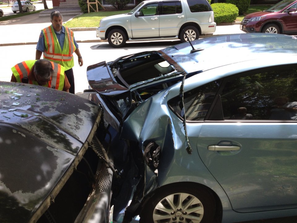

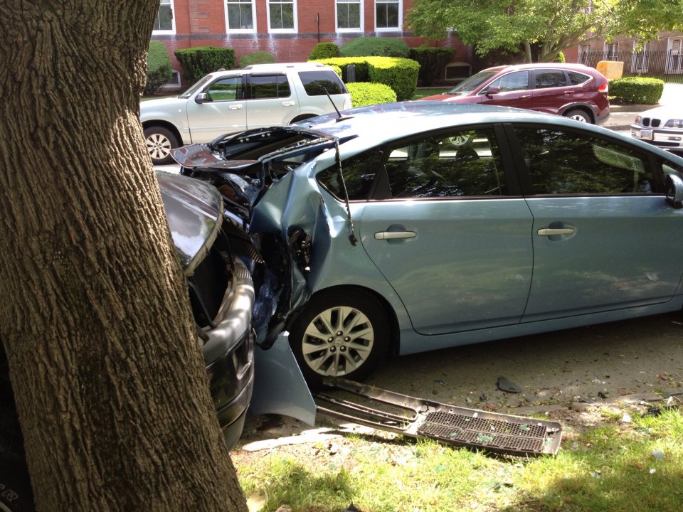

    My 2012 plug-in was parked and a pickup truck lost control around a corner and hit the rear end of the car. It also pushed the car into a car that was parked in front of it. To my disbelief it was not totaled. The adjuster for the pick up's ins. put the bill at $13,400. The car was towed to a local repair shop who has been in business for many years. The accident happened on 6/5/2013. I still do not have the car back. I do have a rental from the repair shop. As time has passed the repair shop told me they couldn't get the parts to repair the car. The parts were ordered, but many of the parts were on back order. Recently they told me the car was finished but they are now making sure the car is mechanically sound (that was a week an a half ago) This car has been sitting for about 4 months. Unbelievable is an understatement, but sorry to say it's all true.
    Any Words of wisdom I would greatly appreciate.

    I haven't read all the responses carefully, but I'm amazed too that it wasn't totaled. To me, the large HV pack was likely damaged and needs replacement, esp. since it extends almost all the way to the back in the PiP.

    Prius does not have a frame, it is unibody. All structural damage will be fixed and will be as new. They simply cut out the bad parts and replace them.
    I would be worried about the traction battery. My gut tells me the car is not holding a charge and they can't figure out why the 12v battery keeps going dead every night. That is what happened with my PiPA when it was rear ended. They estimated $14k in damages, which they would have fixed, but they also needed to ensure the traction battery wasn't damaged and only Toyota can do that. So they would have had to remove the traction battery and ship that to Toyota for certification. That would have cost at least $3,000 which they didn't want to spend. Then if the battery needed to be replaced, that would have been $8k.
    They totaled out my PiPa.
