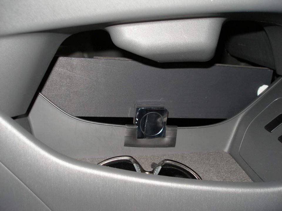

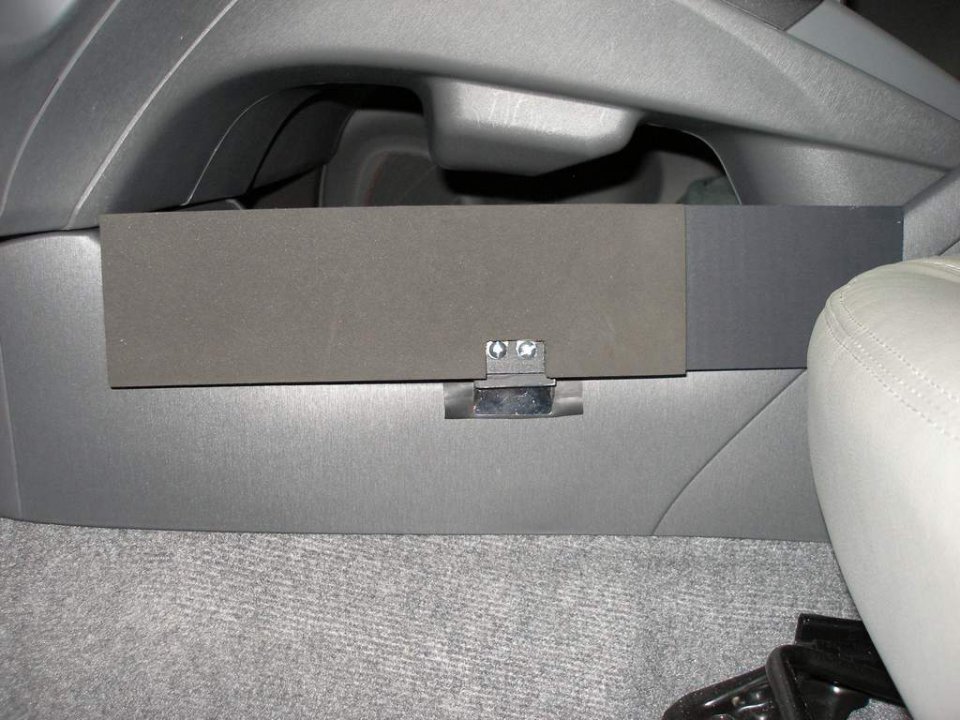

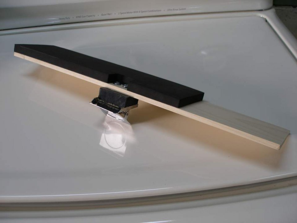

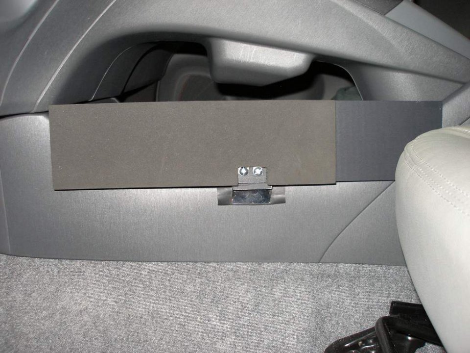

    Like the pics of your mod but had a bit of trouble orienting myself. Am I correct that you installed a hinged, flip-out board about 5" wide and 12" long on the driver's side edge of the bottom of the center console? Nice idea! Did not think the plastic of the console would be strong enough to support the weight of your right leg like that. Does it bend at All? Do you then brake with your left leg or move the right leg off the board for braking? Board is unpadded, right? Thanks!

    The board is very thin 1/4" made of Poplar wood by 17" length, 3 1/2" wide.
    The lower console edge swoops from up to low and back up. The board spans the upward edges and is supported by them. The large clip merely holds the board in place and bears no weight. There is a 5/8" shim between the board and clip and it's attached with screws and lock nuts. There are pads on the board to resist scratches on console.
    Most of the board is covered in 1/2" neoprene foam. I still brake with right foot. I just happen to like feeling a console edge near my right calf. In a Civic, Corolla or Camry, I'd be resting my calf against the console.

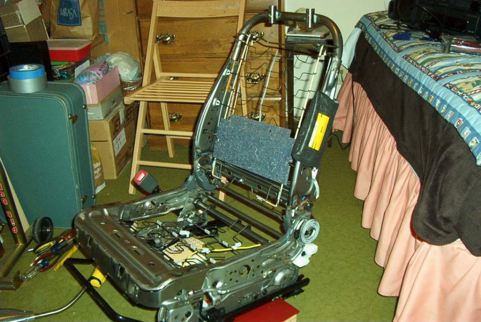

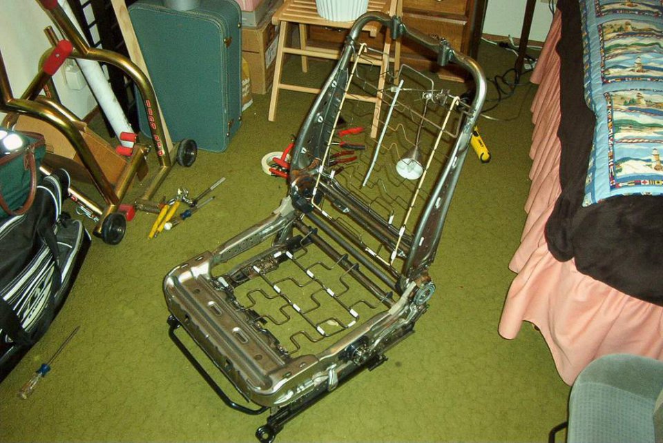

    FWIW, here's a 2006 Corolla driver's seat frame and 2006 Prius frame:
