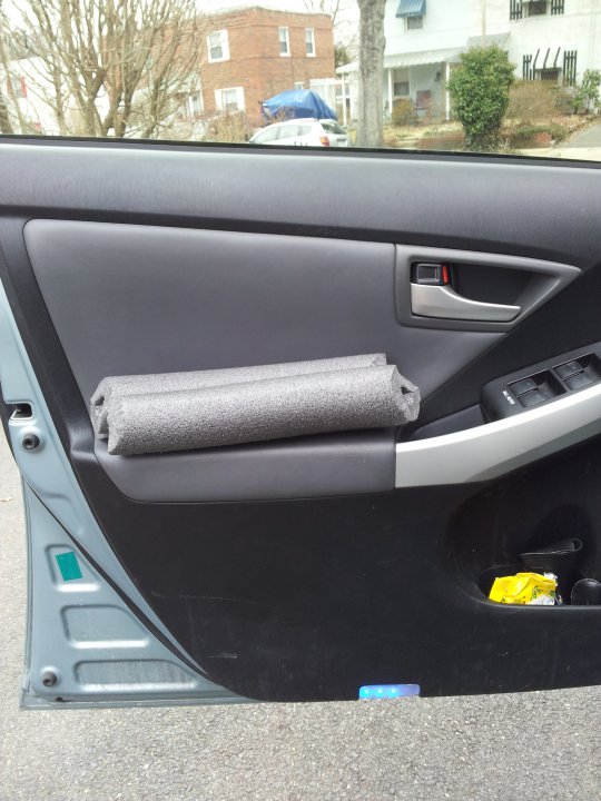

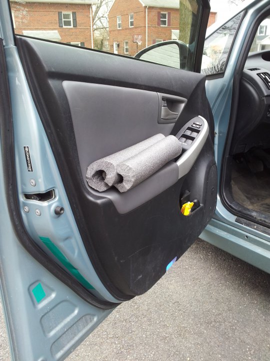

    Problem: the center console arm rest is significantly higher than the door arm rest. This is innocuous for short runs but becomes a big problem for interstate long-haul trips. I used to hold my left arm in my lap - comfortable but kind of limiting on long drives.

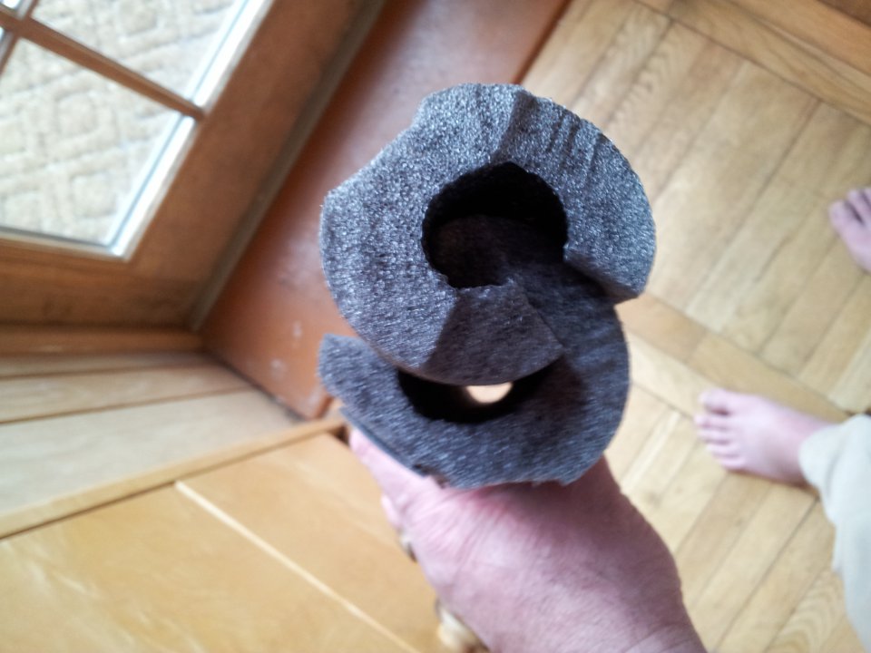

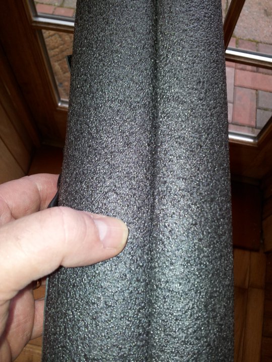

    It bugged me enough that I cut a 4-inch wide pipe insulation 4-foot-long black rigid foam section I had laying around into three lengths, and then S-hooked two of them into each other through their lengthwise slits, then used 3-M double-sided tape to hold the foam assembly on the arm rest against the vertical and horizontal surfaces of the arm rest.

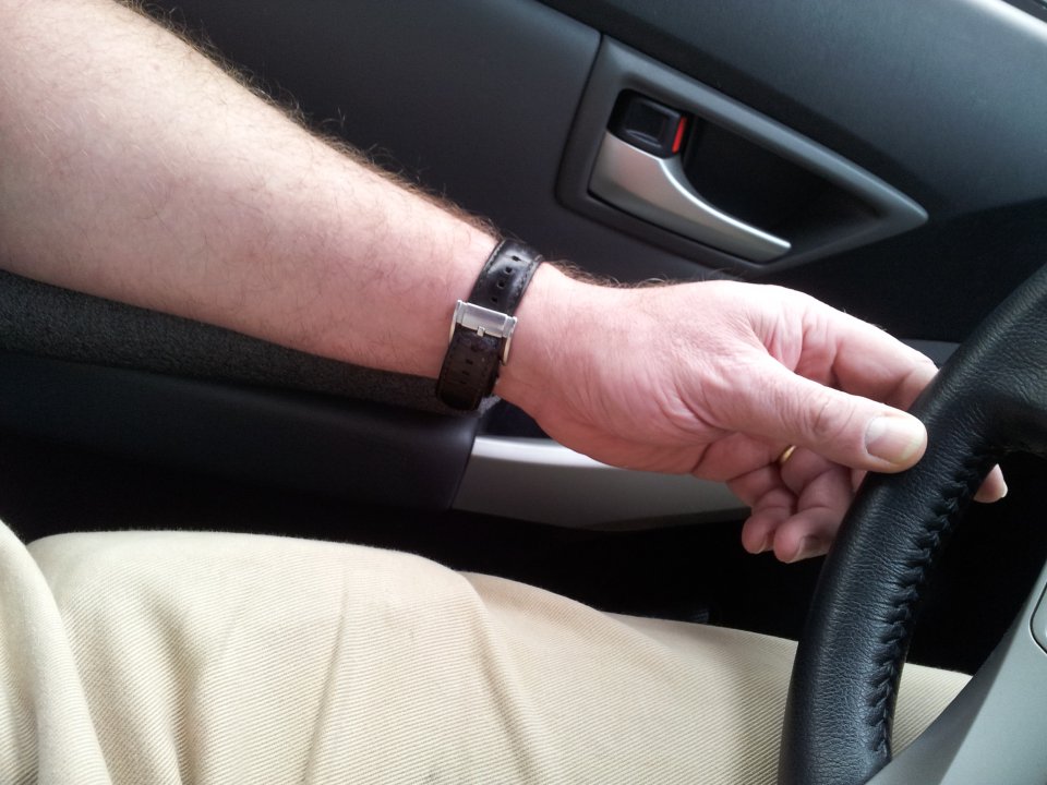

    Funny thing is, although I was worried that a four-inch rise is too much, it actually worked out perfectly. Now, both my elbows are resting comfortably and I control the wheel at 4 o'clock and 8 o'clock position with fingers of both hands. I drove from Northern Virginia to central Kentucky and back twice in the last six months and my arms never got tired anymore. Shows how low that OEM arm rest really is...
    Note: I mounted the Cusco strut tower brace (STB) in Fall 2012, which has made the steering effort both much lighter and much steadier. Now, with elbows comfortably braced, the PiP responds to light finger pressure inputs from either hand on the steering wheel.
    The only problem is the 3-M tape lost its holding power during the recent cold snaps. I plan to slightly carve/shape the foam rolls to better conform to the curves of the door arm rest nook and re-glue the rolls as soon as it gets warmer. For now, I just put the double-S foam rolls onto the left dashboard whenever I get out, where they're handy to emplace onto the arm rest as I get back in and latch my seat belt to drive again.

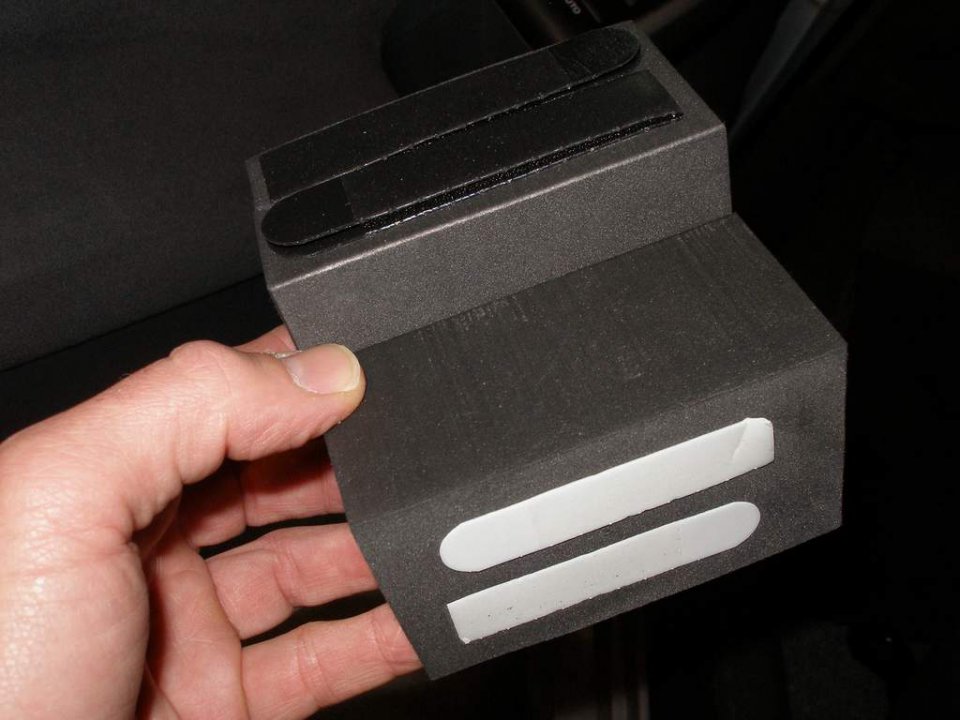

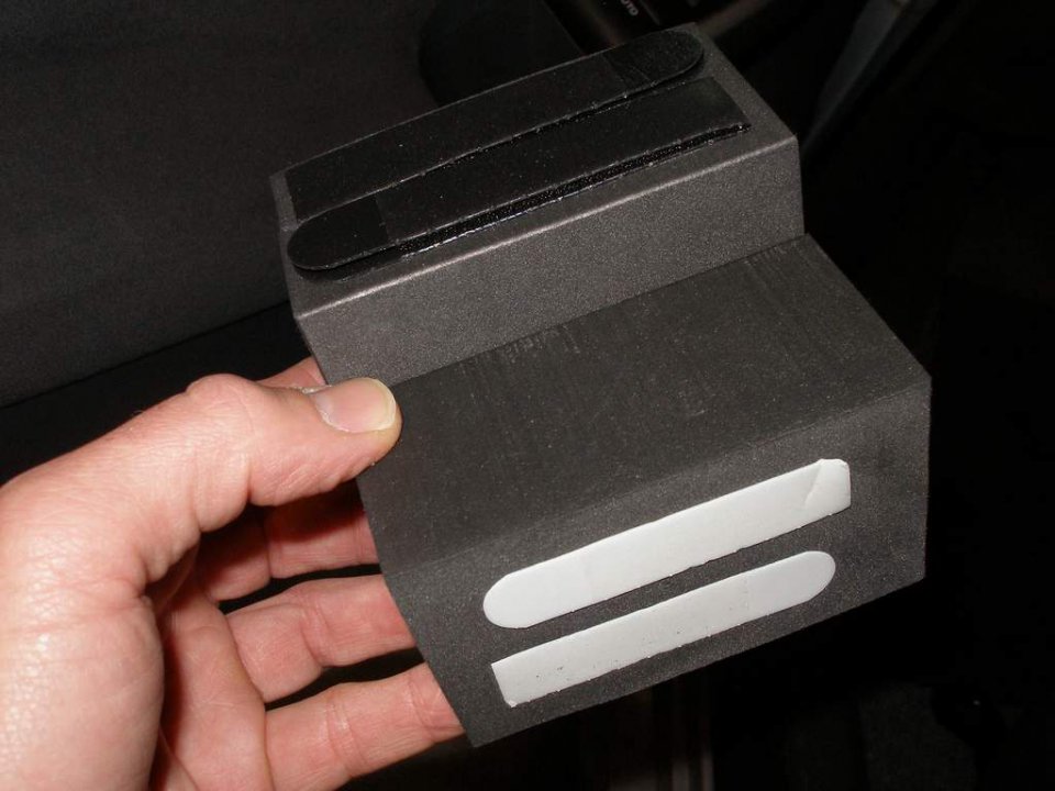

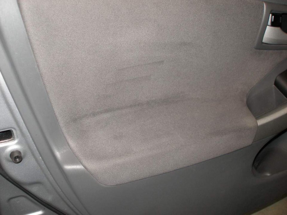

    Just removed my homemade armrest pad camera 560.jpg after having it in place since last December (almost 3 months).

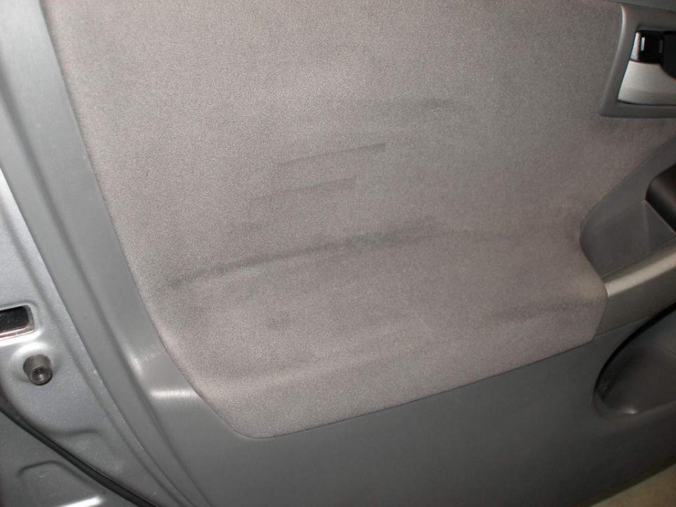

    No adhesive residue whatsoever camera 559.jpg Just a little imprint on the vertical fabric, but should be able to massage that out.
    Going to have some pieces cut tomorrow at Bob's Foam Factory - Home for pad height about 3 inches. Will try about 1 inch pad on center console also, strap it down.

    Thanks for pics!
    If I remove mine, I will have two small screw holes in the bare gray plastic at the very rear of the armrest and two more right up in the front at the back edge of the door handhold. Your method leaves no holes, which is nice.

    Oh, that 3d piece is still lollygagging around in the basement from whence it came :D

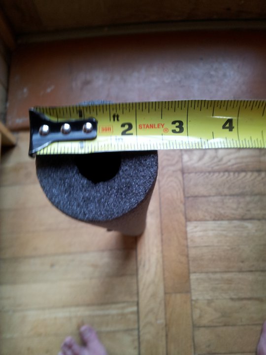

    Here are the pix. BTW - I'll correct the record - the pipe foam is 2.5 inch diameter as one picture attests. Regrets for my error.

    Actually, after looking at your picture I decided to try your 3M Command tape solution (which I had used previously in several home bathrooms). Hope it works with my double-roll foam insulation armrest... Much appreciate the idea.

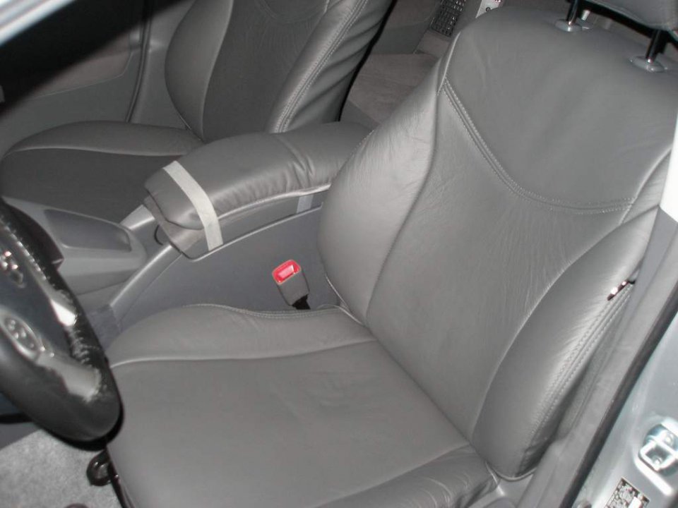

    had 1" x 5" x 8" neoprene foam cut and stuffed it under the leather center armrest cover. Cover doesn't secure onto center armrest, strapped it down. Not so pretty but foam stays in place. A darker strap will help.
    note - leather color not accurate due to flash

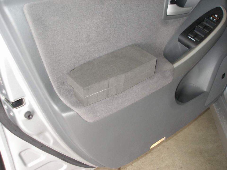

    Ok, so I went back to Bob's Foam Factory, Fremont Ca with templates to make a 2 inch high arm pad. Had to do a couple more cuts to shape it towards the back. Basic, but functional and stays in place well. Will take it off before checking in car for service. They might throw it away.
    2 " high by 8" long

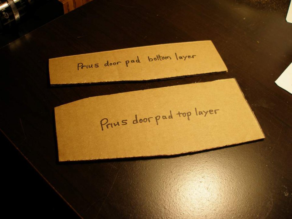

    The templates
    1" x 5" x 8" under the center armrest cover, the center and door armrests are close to same height (yardstick and level to measure)
