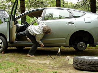

    <div class='quotetop'>QUOTE(hobbit @ May 18 2007, 10:38 AM) [snapback]444997[/snapback]</div>
    I salute your obsessive nature. :D
    This photo made me LOL.
    Thanks, now I can go back to being a complete idiot (never using the parking brake except on steep hills) instead of a partial idiot. :lol:

    well well. how about that.
    DH saw this and his first reaction was along the lines of "no f'in way." he has not yet had reason to actually disassemble a prius rear drum brake in the shop (you know you believe it.) so this was his first look at everything yanked apart.
    to date, what he had seen looked exactly like the parking brake-adjusted systems. so he assumed it was such, given that toyota only says they make two adjustment systems: reverse-brake and parking brake.
    but sure as hell. it is different. no toyota literature he's gotten so far has shown this so he is surprised to say the least! now that he has gotten a good look at it he's certain that you're right, hobbit!
    (meanwhile, he's over here grumbling about those tricky SOBs :lol:)
    edit: he wishes to add that his official stance is now changed to- the only maintenance related reason to use the parking brake is to make sure the cable doesn't seize up.
    and he's still grumbling about 'those bastards!'
