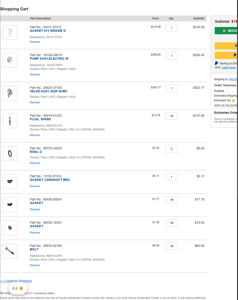

  7. Mendel Leisk
    61,296
    42,165
    New water pump is probably prudent. Ditto for the head bolts. And of course the engine overhaul gasket kit. But:
    New EGR valve?
    10 spark plugs?
    Various misc gaskets, are they not in the gasket kit? That's the full kit, should be quite complete.
    For a flip, I think gasket kit and head bolts would suffice. Spark plugs, water pump are easy to replace down the road, existing EGR valve I would only replace if it has internal damage. So about $300 USD. :)
    Addendum, the gasket kit and head bolts, from Amayama, all-in, is $282.31 CDN for me, that's $203.43 USD.
    On the other hand, the cylinder walls could be scored, the damper could have sustained damage, a piston arm might be bent, and so on.
