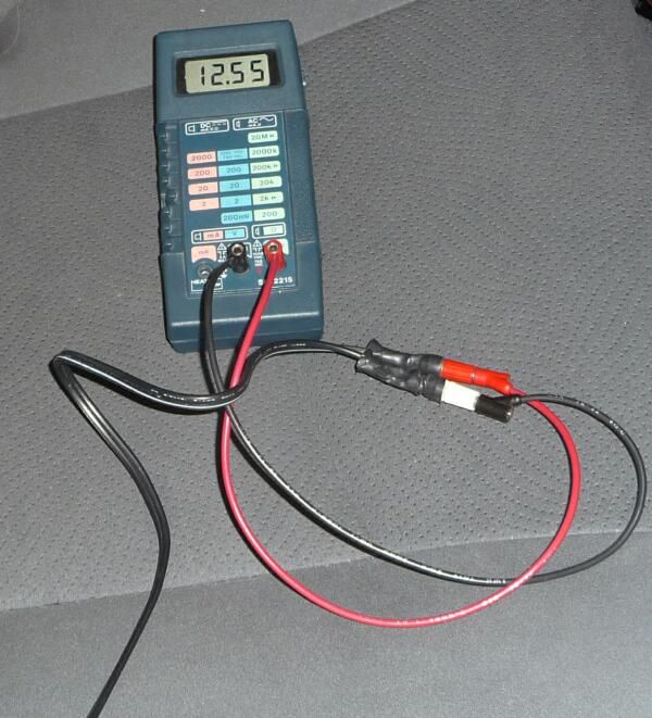

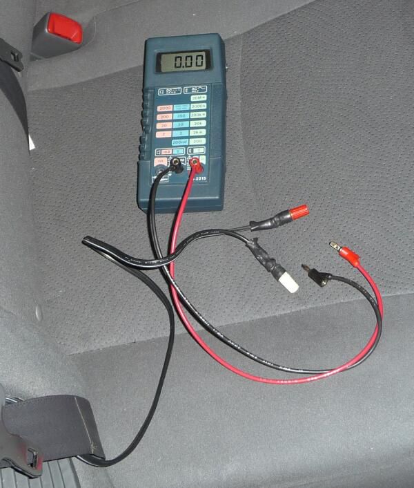

    Checking the battery is pretty easy to do yourself with a multimeter.
    12-volt battery
    Open voltage at 68 °F (20 °C): Manual page 567
    12.6 - 12.8 V Fully charged
    12.2 - 12.4 V Half charged
    11. 5 - 11.9 V Discharged
    (Voltage is checked 20 minutes after the system and all lights are turned off.)

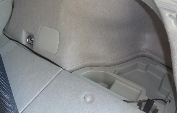

    I have some test leads routed to the back seat so I can have the meter connected and read it through the window after the 20 minutes. That way there is no load except the usual very small 35 ma or so that runs the computer.

    Hey California Bear,
    I love your idea about the meter. Would you post pics please? Thx. I connected pig tails for both our PIPs so I can plug in charger in easily. Only need 1 charger to swap between them.
  12. CaliforniaBear
    CaliforniaBear Clearwater Blue Metallic
    Oct 9, 2012
    1,180
    289
    Northern California
    Not much to show.
    Clips on the battery terminals, wire routed to the back seat.
    Double ended banana plug leads, be sure to plug into the meter first.
    Back windows are tinted so I have to view the voltage with a flashlight in the garage. This
    reading is a little low because it was made without waiting the 20 minutes and door was open
    so dome lights were a draw on the battery. My readings are typically 12.6 to 12.77
    #32 CaliforniaBear, Sep 1, 2014
    Potorap likes this.
