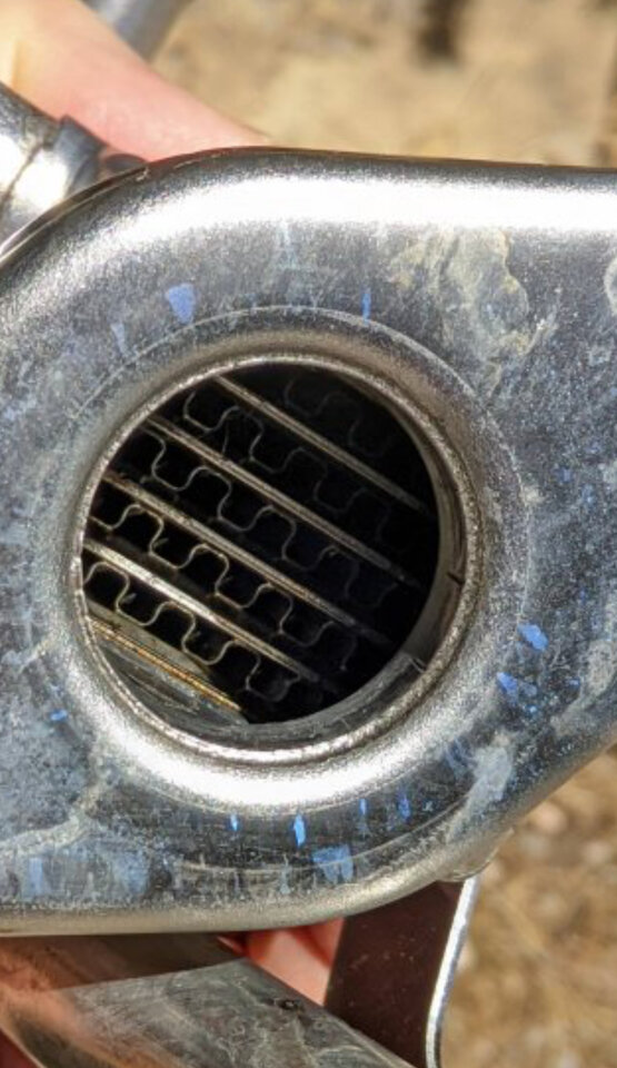

  11. StarCaller
    StarCaller Senior Member
    Feb 15, 2014
    1,284
    733
    Cedar Crest, NM, USA
  12. avoice217

    You can buy new egr coolers for less than $160 on ebay and even less on some of the Asian sites.
    NEW OEM GENUINE TOYOTA 10-15 PRIUS | 10-17 CT200h EGR W/COOLER PIPE 25601-37010 | eBay
    Starcaller's 85k mile cooler looks pretty clean. Most used are more clogged and come from high mile junked cars.
    You don't want to buy the $94 aftermarket egr valve. If you have a 2010-12 Prius, the new revised egr valve may be worth another $150 as the early versions were prone to sticking. Otherwise just clean the 2013-15 valve.

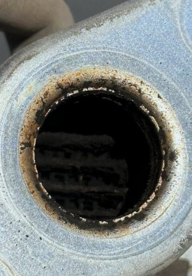

    An egr cooler out of a high mile oil burner (common) will be completely clogged from one end to another with a tar that can be as solid as epoxy. In those cases chemical and power washer methods are only a final step after the multiple small passages are mechanically cleared first. Which can be tough with a rotating wire on the end of a drill.
    If the used cooler looks like this (Starcaller's) you have a chance of chemical cleaning.
    Or you may get this
    The odds are your original cooler is not throwing a code and looks more like the first.
    Personally I used a new cooler the first time and spent days cleaning the original clogged cooler that did throw a code. The second time at 300k miles I used the cleaned cooler.

  19. avoice217
    avoice217 Member
    Jul 20, 2022
    180
    22
    Hey man so I just received the part from eBay in the mail and it looks just like the 2nd photo where its all black. I'm totally open to different ideas on how to attack all the black stuff and letting it sit.

  20. rjparker
    rjparker Tu Humilde Sirviente
    Jun 6, 2008
    11,013
    6,902
    Texas Hill Country
    First, your low mile original is probably more like Mendel's and others who use chemicals. I would clean it in an hour and put it back in.
    A totally clogged example needs wire on a drill starting with shorter wires progressing to longer so you can see a glimmer of light after drilling the curved channels. Then use your choice of chemicals or better yet take it to a shop's parts washer.
