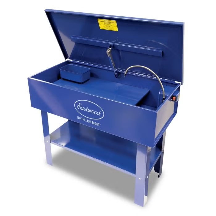

    Would you say that the parts washer includes using a pressure washer by chance? I'm considering getting one for this purpose.

    A shop's parts washer is a tank of solvent with a pump that can be closed. A little more protection. IMG_8688.jpeg
