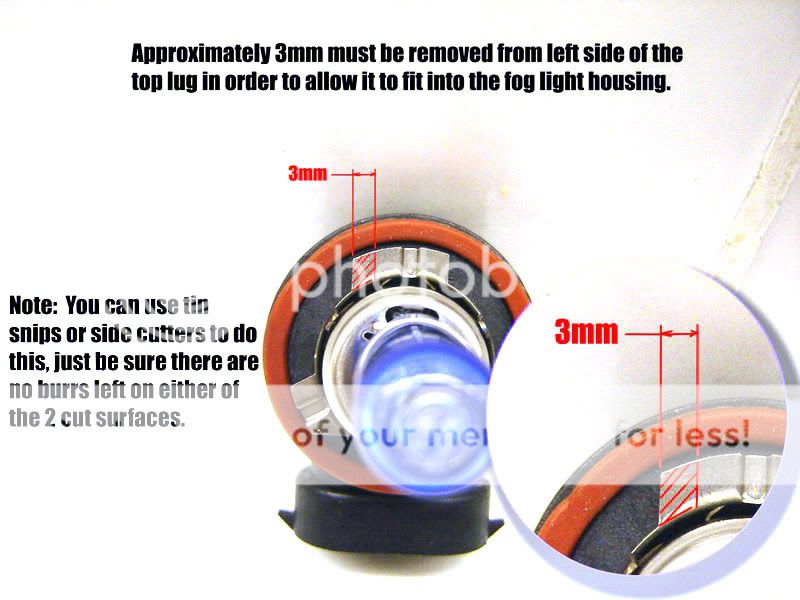

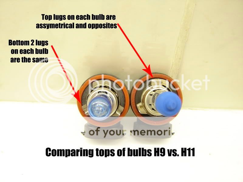

    Here's a pic that shows the difference between the mounting tabs on the H9/H11 bulbs:
    The tab on the H9 at the 12 o'clock position needs to be trimmed a little on the 11 o'clock side by a few millimeters so it will fit into the headlight housing. This can be done with a rotary tool with a grinding attachment, a pair of small tin snips, or a small metal file, etc.

    Thanks. What a pain though.

    Seriously? It is taking you more time to post in this thread and create other threads in this forum than it would take to modify and install the H9 bulbs. :rolleyes:

    Not really. I've read posts from folks that said it took them 30 minutes of hassle each bulb.

    If you lived close to me, I'd do the conversion in front of you in about 5 minutes, both bulbs. Installing them afterwards, now that's the PITA part, especially the passenger side. :D

    I agree. If you have a dremel its 5 min per bulb. I did the conversion about 3 month ago on wife's 2010 and have been very happy with light output. Very similar to my factory HIDs in my 2005. No negatives so far.
