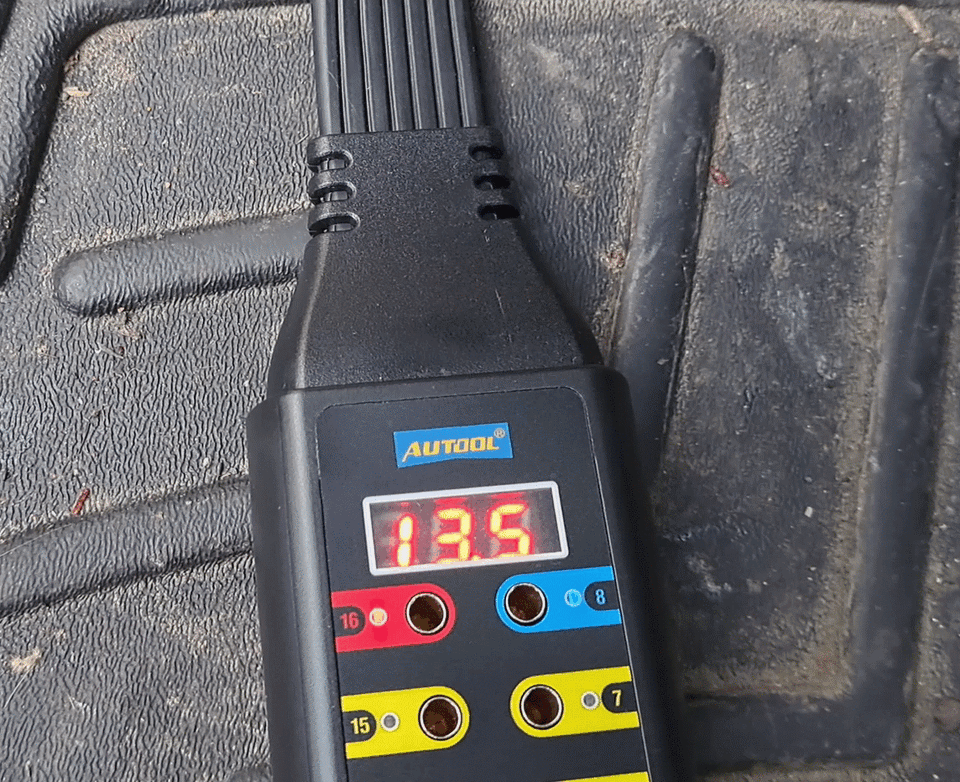

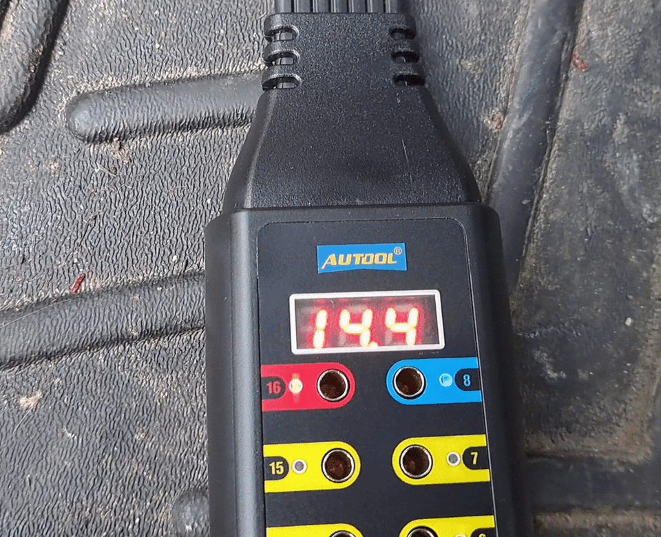

    I'll revive the topic about poor mpg on Prius V.
    I bought myself an obd2 breakout box and decided to test it on my car and found something abnormal.
    My car is 2012 prius V 5 with 230k miles, built on 3/2012. MPG is 37.2 as of today. 37.2 is the highest number i've seen on this car. When I bought it, 7 months ago, with 218k miles, MPG was 36.6. In the park position, the voltage is 14.3-14.4. When i put it in drive, the voltage drops progressively to 13.5-13.6 volts in about 3 seconds.
    I also checked voltage on 2013 and 2014 Prius V with 211k and 218k miles and the voltage was stable at 14.3 volts in park and drive.
    The 12v battery on my prius is fresh, bought in 2023 from Toyota. The hybrid battery has been reconditioned, taken from the 2014 Prius. The EGR was cleaned at 218k miles. The hybrid battery from my car is now in the 2014 Prius V and everything is fine there, so the battery can be ruled out.
    Does anyone have any thoughts or ideas?
    I'm going to diagnose it when I have time. I think this is the reason for the poor mpg.
