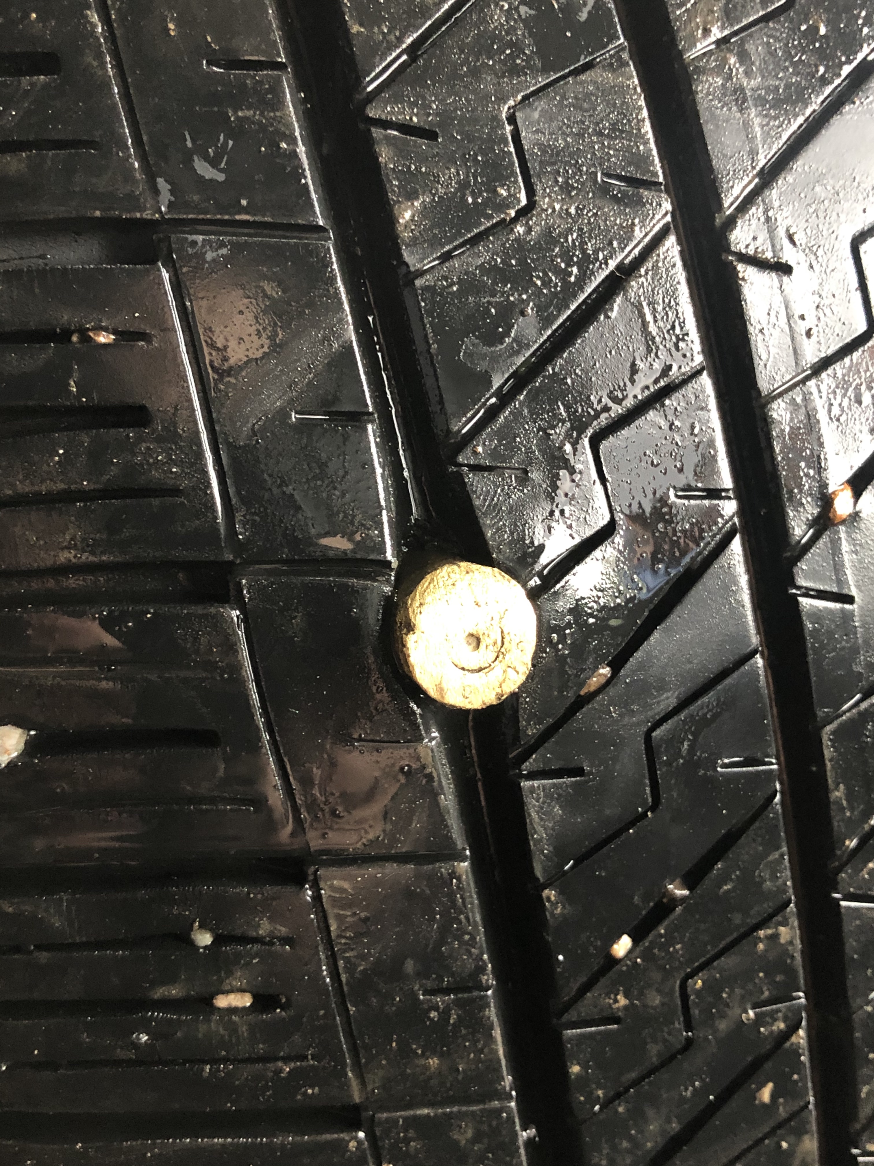

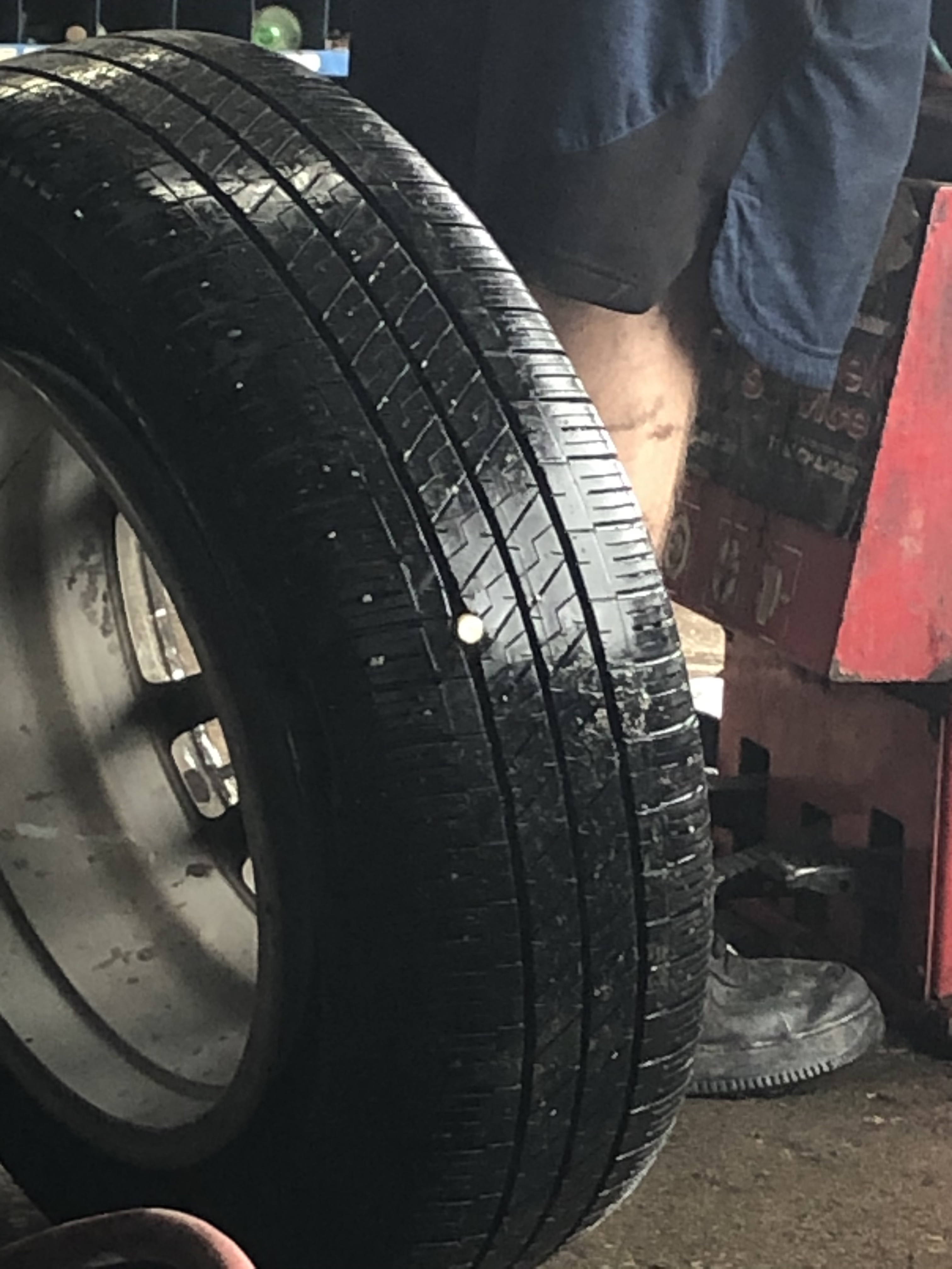

    Due to the pandemic situation in the past year, it's been parked mostly or driven very little. This week I started to commute back to work and it looks like I was going through a war zone!
    a bullet shell!
    well it was too big to patch. So I got a used tire. When I was putting it on I must have over tightened the studs and one of them broke.

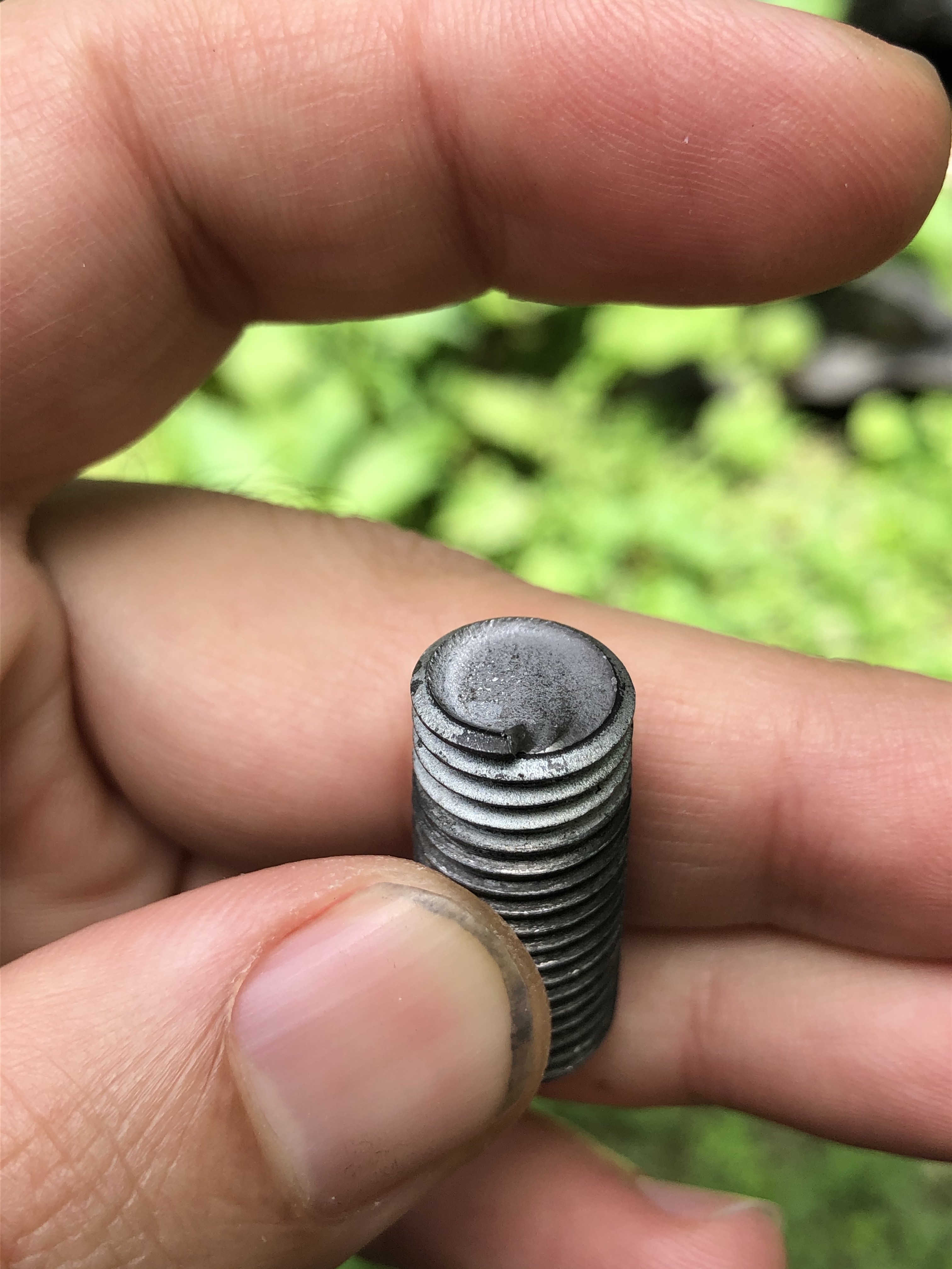

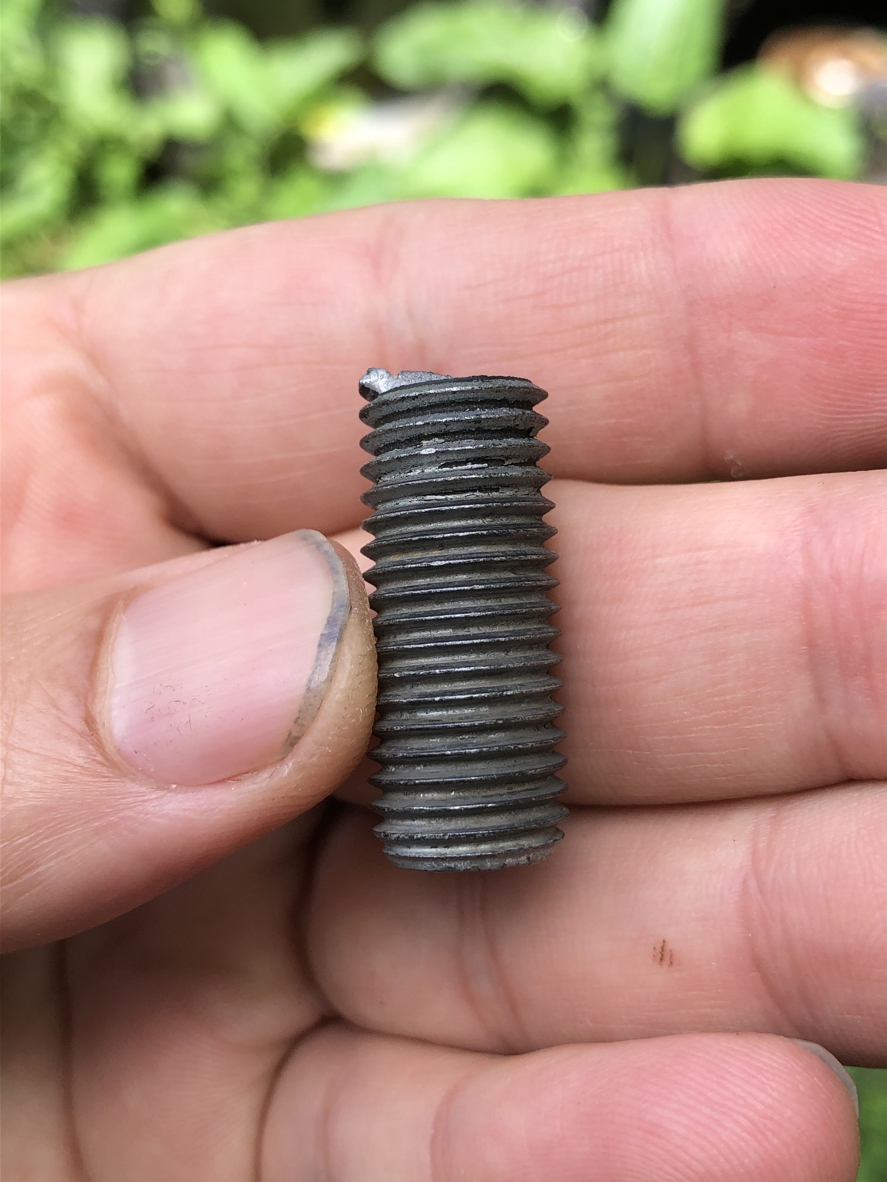

    it's NOT rusted as hell. I am not expert in metal fatigue but here is what it looks like.

    Doesn't look rusty at all to me. (Chicago boy - I know rust!)
    Takes a fair amount of torque to break off a wheel stud. (Don't ask me how I know - or - "Who knew that cars in 1964 had left hand threads on one side of the car!?")
    Owner's manual calls for 76FtLb torque - but I suppose I'm one of the few guys who would actually use a torque wrench when tightening lug nuts.

    Still another BTW - even with working on rusty, old Chicago vehicles, I've never seen a wheel stud break off due to rust. Broke off a couple myself from turning the wrong way on a LH thread, and seen many a wheel "frozen" to the hub and studs damaged by hammering on them.
    Beating the broken studs out is pretty easy with a punch and a heavy ball peen hammer. Pulling them back in is easy as well, just screw the lug not on (without the wheel) "backwards" (with the flat side against the hub). Tighten until the stud is pulled into the hub with the "head" of the stud tight against the back of the hub.

    You need new glasses.
    Do you SEE even a hint of rust on the broken stud ??
    Valiant V likes this.

    Glad it's not just me. (Who can't see any rust)
    Sadly, I know all too well what rust looks like....
