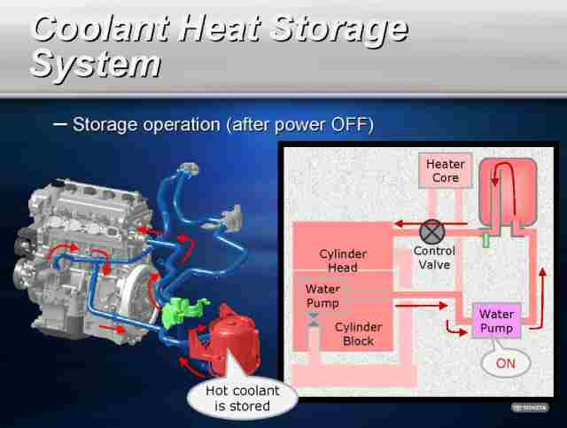

    It's not a gurgling sound at all. It sounds more like a fan. Is there a fan that runs during operation and after shutting off?

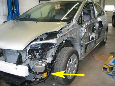

    The sound from the driver's wheel is normal, it's the thermos pump working for 10 seconds at start and shutdown

    What you are hearing is probably the CHRS (Coolant Heat Recovery System) running to store hot coolant in a thermos type container at shutdown. It then pumps that coolant back into the engine block to pre-heat and get the car up to temperature quicker. It is all in aid of lower emissions at the tailpipe.
    The other noise you will hear when car is off is the brake accumulator pump running to keep pressure in the brake system, as the car runs for significant time with the engine off, it can't use manifold vacuum like non-hybrids do.
    Both normal sounds and nothing to worry about.
    Hope that helps.

    In the gen 2 (2004 to 2009) they used a 'thermos' under the driver's headlight to store hot coolant so the car would warm up faster. When the car is stopped, coolant is pumped to the Heat Storage System, and when restarted, it is pumped back out.
    I bet this is the noise you hear. It is normal.
