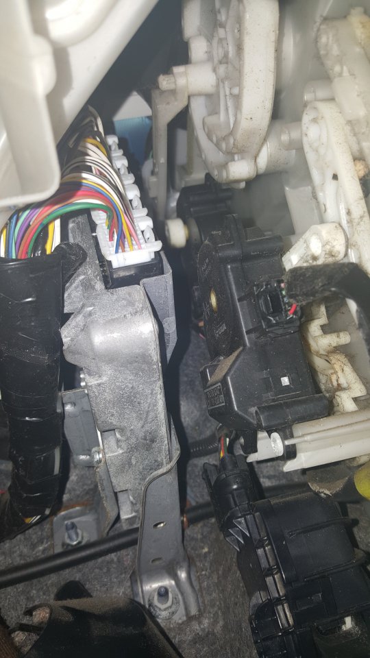

    How would you go about figuring out this intermittent issue that is not currently occurring?
    ETA: I had an intermittent issue with my HID lights that was caused by a tech not replacing seals properly while diagnosing another intermittent issue caused by an old bulb. If could jiggle the connectors between the actuator and the ECU myself I would do that. If the intermittent issue occurs again after the new actuator, I might pay for the disassembly so someone else else could jiggle the connector.
    ETA2: Your raising this point did help me to consider something I hadn't: If the ECU gets exposed or nearly exposed with the disassembly needed to replace the actuator, I should have the installer remove and replace the Skid ECU connector a few times in order to possibly dislodge corrosion which is a possible source of the code.

    Yes, the bag of tricks for pinning down intermittent opens or shorts includes careful eyeballing, then things like shaking and jiggling, possibly escalating to water spraying, and so on. It is mostly common sense and inventiveness, with a light seasoning of deviousness.
    The actuator is out under the hood and the ECU is in the instrument panel inside the cabin, so no, the disassembly for one won't help with access to the other.
    You see the ECU by sticking your head where the driver's feet go and looking up.
    For replacing the ECU, the repair manual (more info) officially says to get the whole steering column out of the way first. Which probably does make access to the ECU all easy and convenient, but might be overkill for just getting to the wiring connectors with a meter. Taking off the steering column lower cover might help, and that can be done without removing the airbag or wheel. There are two Phillips screws to come out from behind the steering wheel, and you can see both of them just by rocking the wheel a little to the left and then to the right.
    Still, those repair manual procedures like "remove steering column assembly" provide perfect cover for a tech who would really rather not be bothered with some fussy testing. "Oh, that will take $700 of disassembly" serves the purpose nicely.
    It usually saves time to let the testing approach be guided by what you know you're looking for. If you had INF 26 or 27, you would be looking for some intermittent open circuit, and dislodging corrosion might be on your likely-suspects list. Because you have INF 28, you are looking for a short between the SLRFL circuit and a source of 12 V power, and simple corrosion would be lower on the suspects list for that (unless you find a big-enough track of corrosion somewhere to bridge two circuits). A pinched wire or damaged insulation or the like might be higher up the list.
    Also, because the actuator is outdoors and the ECU is indoors, they don't both invite the same bag of intermittent-catching tricks. The water-spray trick would be perfectly fair where the actuator is concerned, but probably a little overly devious around the ECU.

    Those are good tricks to know, and I thank you for posting them. And to clarify:
    Let me see if I understand your troubleshooting suggestion correctly... you would connect a voltmeter to the B1+ (perhaps later B2+) wire as it comes out of the actuator harness (or at the skid ECU connector on the other end of the harness), get the car running and into a state where that voltage is close to zero (I'm not clear about whether this means brakes on, off, or just ABS not in use), and then shake and jiggle or whatever until the meter shows above 12V?
    If the jiggling causes the 12V+ then trace down how the 12V is getting in. But if no jiggling causes 12V then replace the actuator?
    This might actually be something I'd take the time to explore myself. I have opened the dash around the steering column to connect aftermarket accessories, and I actually have installed a terminal block near the steering column for that purpose. I suppose it is possible that I could have accidentally dropped wire strands into the area, or jostled the ECU wiring into a piece of sharp metal nearby for instance. It has been more than a year since I did these things, but still it might be a long shot worth taking to poke around there. Thanks for laying all that out for me.
    Interesting. If only I was looking for an open circuit, I might be able to unplug/replug the connectors, but as you say it sounds like this is not likely to help solve an intermittently closed circuit.
    Yep, this is why I usually bring my car to smaller garages for big repairs, where the tech might even be the one writing up the order. But knowing that it is possible to speak directly to a tech at the dealer is also good to know for future reference; I didn't even know that was possible until the other day.

    Probably simpler to just connect a meter between the SLRFL terminal (the one the ECU is griping about) and ground. That meter should then always read close to zero except when the ECU wants to release pressure from the left front wheel. So it should be close to zero most of the time.
    The code you have is effectively the ECU saying "dude, I just saw the SLRFL valve get powered somehow, and it wasn't me doing it!".
    Then if you manage to shake or jiggle something into sending 12 volts to that valve when the ECU isn't, that should show up on your meter (and might also earn another gripe from the ECU). Some multimeters will have a min/max trigger mode you can select, where if the voltage suddenly increases from where it was, the meter will beep and hold that new reading. Another item in the intermittent-fault-hunter's bag of tricks. Saves you having to keep your eyes on the meter while you're trying to shake stuff, and the beep will catch things faster than your eyes on the meter would anyway.
    Well, if you're able to find the issue by shaking stuff, and you can track it down and fix it, then you're done and you know it. If not, then you're just back to having observed an intermittent fault and not been able to reproduce it yet. If you wanted to replace the actuator at that point, it would just be because that's something you're leaning toward anyway; trying and failing to find where the +12 got on to SLRFL wouldn't really have given you any new reason to do it.
