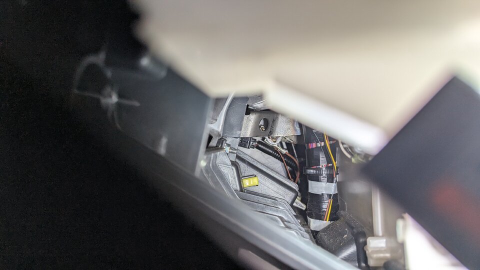

    I pulled the glove box out to check out some of the wiring in the dash and I saw this broken brown wire. What is this for? The photo was taken in the glove box area looking at the driver side. It's near the key fob slot.
    I also found a little mouse house and some droppings in the tray under the blower motor so I'm preparing myself for some rat damage.

    Woah, that's super weird for a Prius, especially when it's hot! Since disconnecting the 12v battery helps, it sounds like something might be getting stuck or overheated, maybe in the "combination meter" (that's the dash display). A lot of people with older Priuses have problems with that thing. You could try looking up "Prius combination meter repair" on YouTube, it's a common fix!

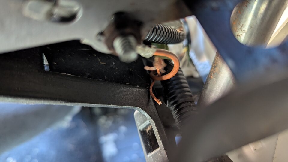

    Do you have a larger or zoomed-in version, or one where you could add a circle or arrow for the wire you mean? I saw some brown wiring in your attachment, but I'm not sure I saw a break.

    Yeah I got a different angle when I pulled the dash apart. There's two brown wires that were broken that I reattached to the metal piece they broke off of.

    The two broken wires were branching off of the main dash harness a few inches away from the shifter.
