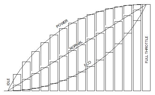

    No. It simply moves the throttle plate more for less initial travel of the pedal, leaving more pedal travel closer to the floor with less effect.
    It is doing nothing you could not do in Normal or Eco by pushing the pedal further.

    Toyota had told us (back in 2010) that it only changes the first 50% of pedal travel and after 50% pedal travel to 'full throttle' all the modes act the same.
