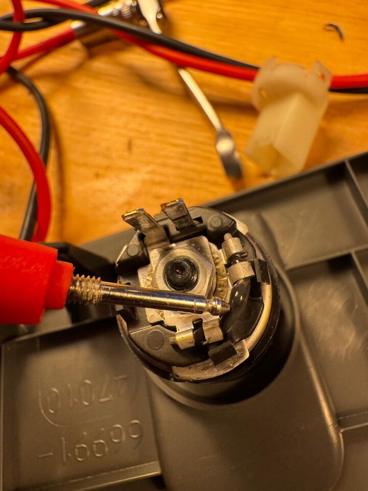

  9. overexposure
    overexposure Junior Member
    Jan 22, 2018
    amsterdam
    A bit late but the fuse inside the power outlet is blown, its a small black wire inside the outlet
