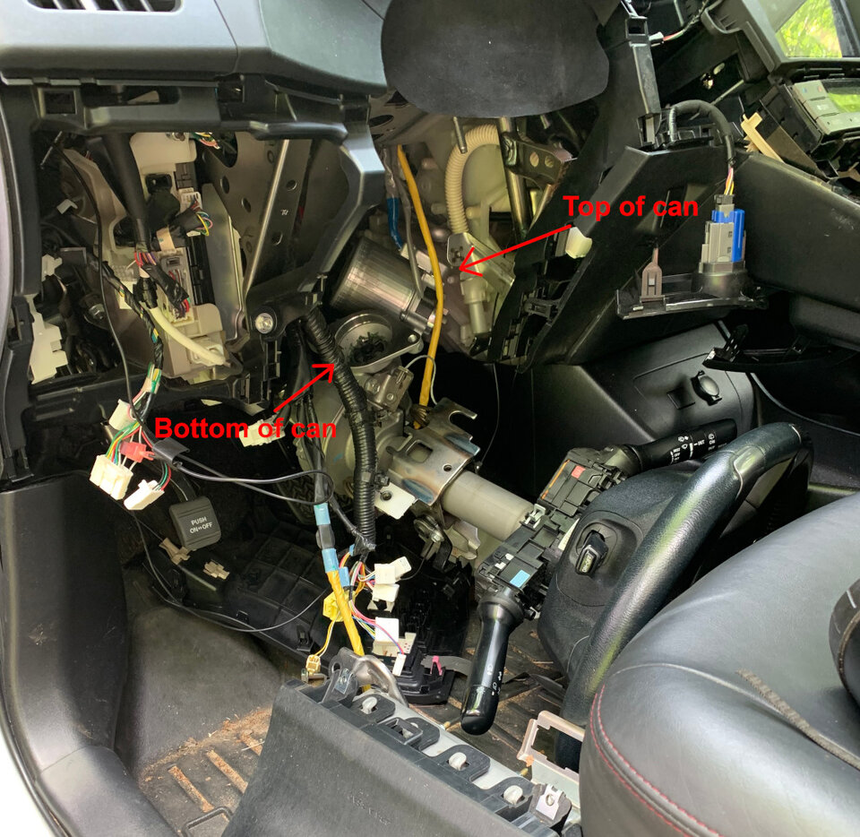

    We have a 2013 Prius which had an annoying rumble and rattle on bumpy pavement, apparently emanating from the steering column just behind the dash. We visited a few websites, among them
    , and learned that the problem could be a damaged interface part between the power steering module and the steering shaft. The mechanic who presented in the above website was acting on the recommendation of a fellow mechanic and was initially skeptical, thinking it more likely that the problem lay in worn u-joints in the shaft segments.

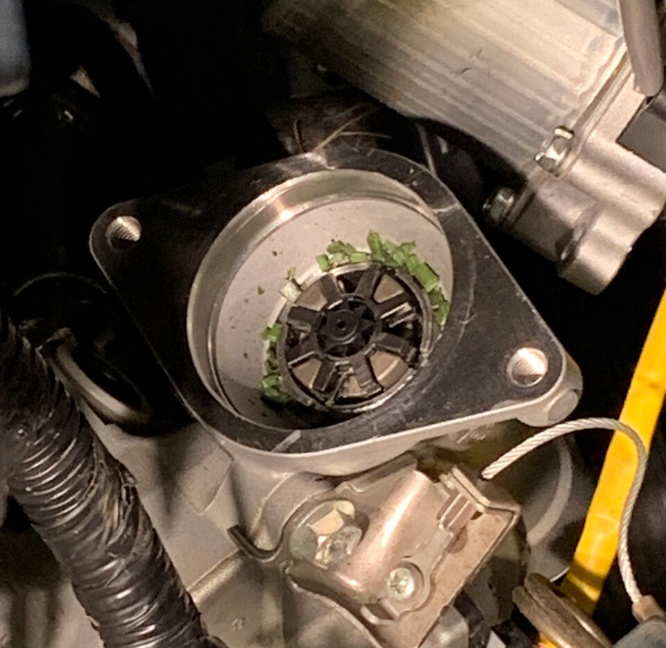

    In fact, he found that it was indeed the power steering interface, where a small, $8 gear-like plastic part in the form of a three-layer sandwich (Toyota Part No. 45254-28040, called a "Steering Damper") which interfaces the power steering module to the steering shaft, had failed. Specifically, the middle layer of the sandwich had disintegrated, apparently rendering the part no longer useful as a "damper".
    We decided this was very likely the problem we were having with our 2013 Prius and that we should look for a professional mechanic to replace the steering damper. We live in rural upstate New York, some 50 miles distant from the nearest Toyota dealer, so we started by asking four local auto mechanics if they would be willing to do the work. They were polite, but they all firmly declined. Then we went to the dealer, who agreed to do a $86 "diagnostic" on the car, and subsequently recommended replacement of the entire steering shaft assembly for which their estimated charge would be $2,526. That convinced us replacement of the steering damper would have to be DIY project.
    The key to the job is gaining access to the power steering unit, a can-shaped thing perched on the steering shaft far back behind the dash. Getting to the can necessitates dropping the steering wheel and shaft assembly to the floor, which requires removal of some plastic dash panels and an air bag module in order to access the bolts which suspend the steering shaft. (Not wishing the air bag to accidentally blow up, we disconnected the 12-volt battery in the stern several hours before starting the work to make sure that any lingering capacitance discharge would be dissipated). Most of the plastic panel removal is of the pop-out type and we recommend plastic tools designed for the task.
    Two of the steering column shaft-support bolts are relatively easy 12mm. The third is a stinker, but it can be had. It is located pretty far behind the steering wheel, a long 14 mm bolt which runs horizontally through the center pivot bracket for the steering wheel height adjustment and which engages a captive plate nut on the opposite side of the bracket.
    Note that all of this work is done on your back in a pretty tight spot, and you will find it to be uncomfortable.
    Once you can get your hands on the power steering can you will find two 12mm bolts that connect it to the shaft. Open up the interface and there will be the prize, the plastic gear-like thing with disintegration-product green pieces scattered all around. You can pick out the gear, vacuum out the green carnage, pop in a new part, and rejoin the can to its neighbor. This seems too easy. Then refasten the steering column hangers and put the plastic dash covers back in place (be sure to reconnect all the electrical plugs you had to remove), which is not particularly difficult but is definitely tedious.
    Reconnect the battery, start her up and take a quiet test drive.
    Here's the steering wheel on the floor, with the can opened up.
    Here's the detritus from the old steering damper.
