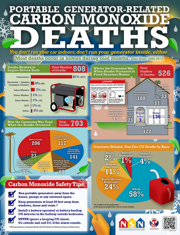

    This is much harder:
    • Prius runs intermittent, not continuously like a generator
    • Prius has a very efficient, catalytic converter, not like the simple muffler on a generator
    We may have to agree to disagree on this because of the metrics:
    Asking Google for Prius carbon monoxide deaths: Keyless Ignitions Led to Carbon Monoxide Deaths and Should Have Been Recalled, Suit Says - ABC News
    According to the suit, filed in Los Angeles Federal Court on behalf of keyless car drivers Wednesday, there have been at least 13 deaths -- and a number of close calls -- from carbon monoxide poisoning after consumers failed to manually shut off their engines. The suit claims, “Reasonable drivers mistakenly believe that removing the Keyless Fob from the vehicle turns off the engine.”
    Off hand, it looks like 13 deaths to 526-808 deaths. We also know these 13 deaths included non-hybrid, START-button cars.
    We've discussed this issue in the past so search should be able find the CARB database showing the carbon monoxide levels from the Prius versus other, non-hybrid 1.8L cars. My memory is the Prius has a greater than a 10-to-1 lower CO ratio.
    I don't recommend ignoring the Prius exhaust as much as pointing out in the world of relative risks, the Prius is pretty low on the CO totem pole.
    BTW, I recommend upgrading your smoke detector with a combination smoke-and-carbon monoxide detector. They last 10 years and the technology has improved. A cracked gas heater core or leaking exhaust could you stone cold dead and we're headed into cold weather.
