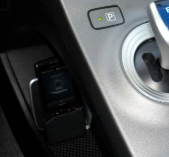

    Well, I went and did it. Since I use a BlackBerry Torch, my install will differ but it might give you some ideas. There are 2 problems with Powermat in a car:
    1) Powermat requires 18v DC. You can solve this if you can find a cheap laptop car charger that will convert 12v to 18v.
    2) You have to find a way to prevent your phone from sliding off the charger. A horizontal placement is not so good in the car anyway - at least for me - I want to use the phone display to see the Caller ID since my head unit does not display it (that might be a BlackBerry) issue.
    Anyway, I solved those problem to my short-term satisfaction (the holder is pretty ugly) and will work more on it in the spring when it warms up again.
    For the curious, I've attached a couple of pictures. The Caller ID display is much easier to see at a glance than the picture suggests. For the very curious I've attached a write-up of the modifications and install.
