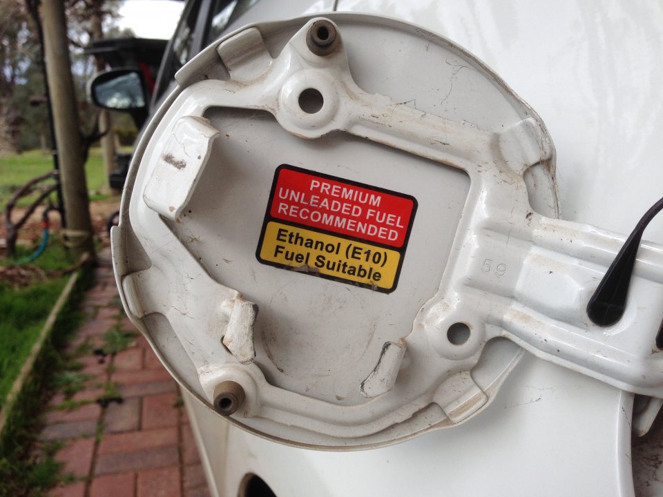

    Sorry that's BS! I don't know North American Premium so can't really comment but Aussie Premium is, in my experience a superior fuel. Prius premium label.JPG Especially for longevity. I've attached a photo of the label on the petrol flap on my 2010 Gen III.

    Exactly, in California you have two negative factors, heat and lower grade fuels. Older motors will certainly generate more power with premium fuel and less chance of knocking on hot days. Again premium fuel is cheap insurance if you intend to drive it to the wheels fall off.

    And in the UK the lowest quality fuel available IS Premium 95 which is what Toyota recommend.
