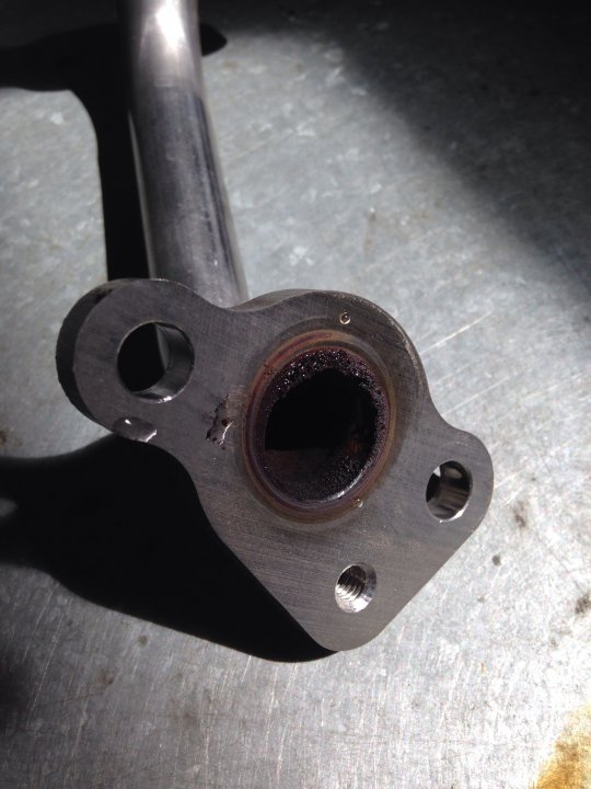

    I took a look at the connector pipe shown in that thread; at 46000 kilometer it was starting to build up. Not really constricted yet, but a decent coating. A lot of our driving is lower speed, and some highway with 80 kmh limit.
    (It's a little thicker right at the flange, not the same all the way through.)

    Interesting to see that much build up for such small mileage
    I'd say that 75% of my driving is city driving and with 75k miles (120k kms) on mine, it'll be interesting to see what it's like as I'd say that it's never been done. I'll try to get a photo when it's done

    75k? That was about the time mine failed. No warning or drop in performance or economy. One day it worked, the next it started playing up and the day after it was banging and clattering.
    I'd be curious to see what yours is like inside. Lots of photos please.

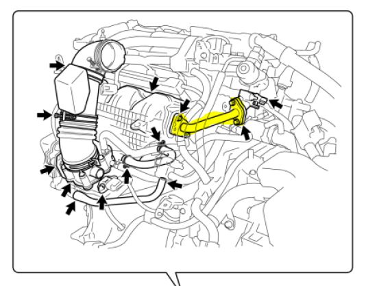

    That pipe hooks into a big black thingy going across the front of the engine, with coolant hoses running in/out. This is the hub of the Exhaust Gas Recirculation system, I think... I mean, I'm looking at the (sorry excuse for a) Repair Manual, but it's so cryptic/terse. That object looks to have similar clogging, and removing it would mean opening up the cooling lines.
    Seems similar to the spark plugs, Toyota doesn't put high priority on easy maintenance access.
    Addendum: big black thingy is intake manifold, I think. :oops:
    (In above, EGR valve at right end of that pipe (highlighted in yellow), intake manifold at left end)
