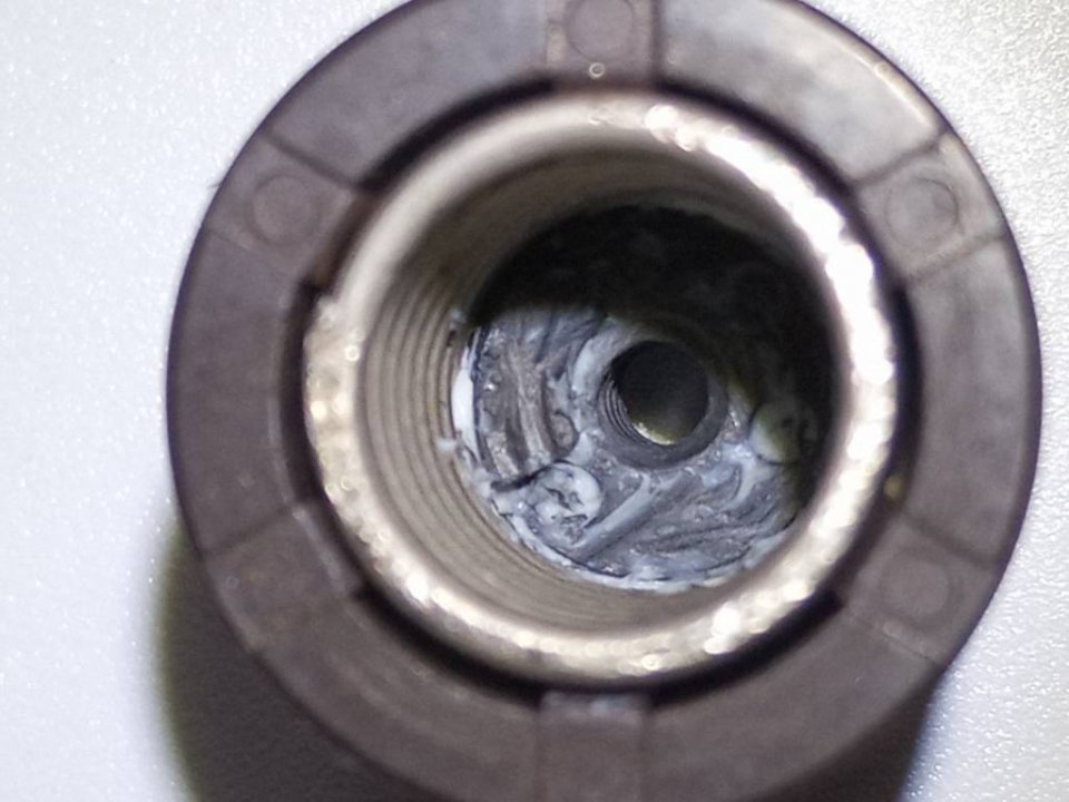

  5. ChapmanF
    28,751
    19,056
    ... but make sure to take the valve apart and eyeball the ski-jump-shaped stop inside the rotor, make sure it isn't mashed. Mashed would be a reason to replace the valve.
