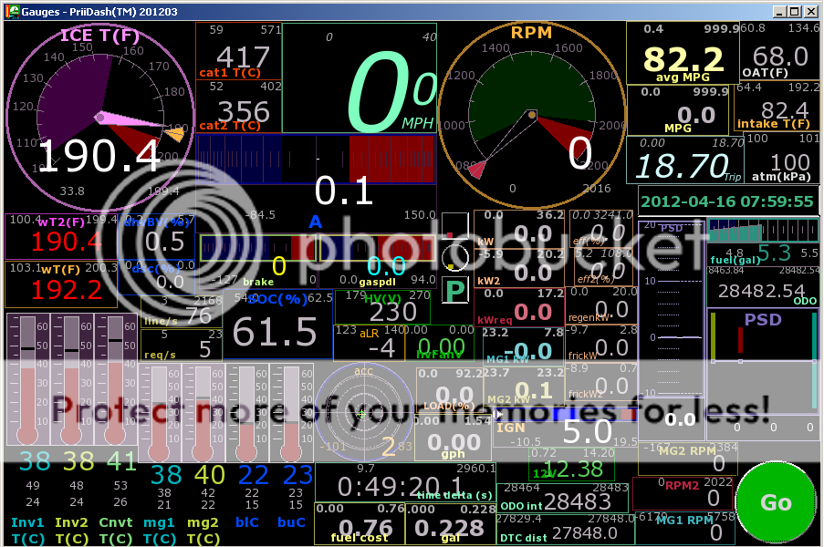

    2012-06 Major Update Release
    PriiDash now can be used in any car that supports standard OBD-II interface. Customizable commands and formulas can now be configured by the end user to selectively decode and display data to suit individual user preferences. Please see the project home page
    PriiDash(TM) - Enhanced Instrument Panel and Data Logger for the Prius and more
    for more details and new installation/usage instructions. Drive safely and enjoy! :)
